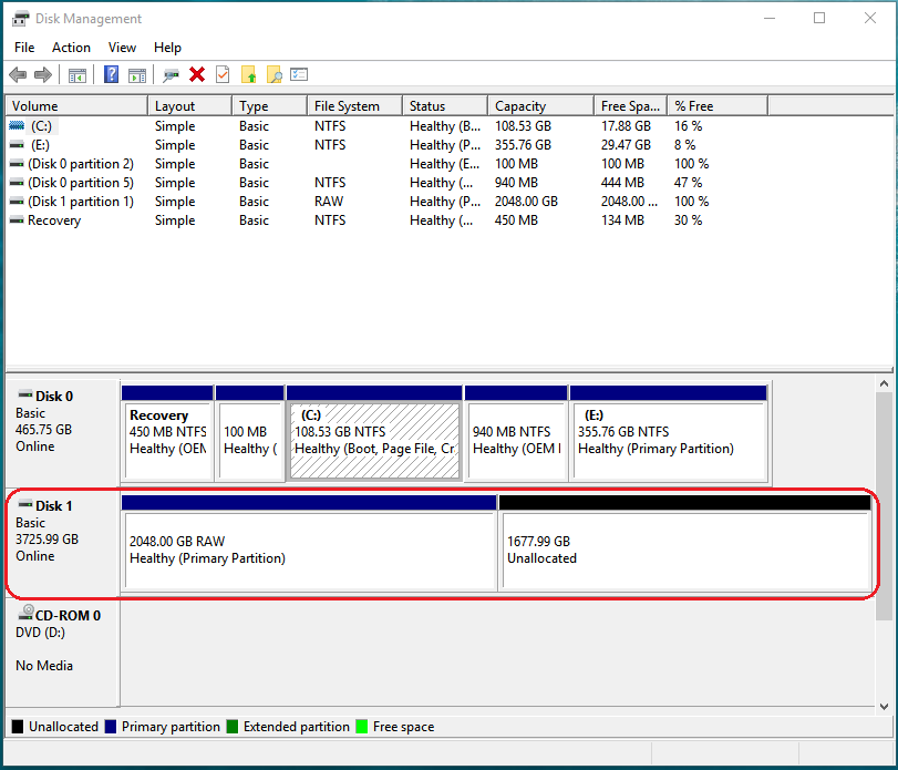

I have a 4TB WD external drive that I was using as removeable storage. The whole drive was a partition. No further divisions. For some reason it stopped working due to some power issue. After getting the power issue worked out, when I reconnected I was unable to see my content. Currently it shows as below in the disk management.
Disk Management pic.png (47.79 KiB) Viewed 6857 times

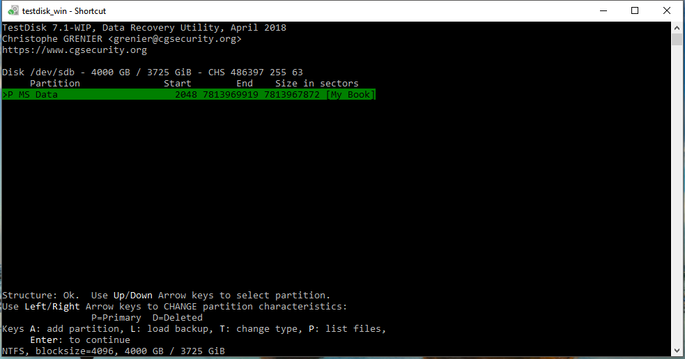

Right now I have connected the drive through a SATA to USB2.0 connector. When I run testdisk on it, the drive shows up as a single drive along with my main drive from the laptop.
After searching for lost partitions, testdisk does find the old single partition and shows it as:
testdisk 3.png (41.88 KiB) Viewed 6857 times
At this stage when I press "p" to have a look at the files, I can see it list all the files and folders perfectly fine. The whole drive and its contents are visible.

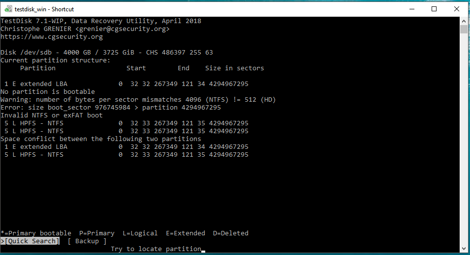

Next I tried to change the type of the drive to logical and then restarted the computer after write command and now it shows the following when I "analyse":
testdisk 2.png (38.85 KiB) Viewed 6857 times

Re: External Drive - Used as single partition - showing in TestDisk but not recovering
Your disk was using 4k sector, it's now detected as using 512 bytes sector only.
HDD using 512 bytes sector and PC Intel partition table are limited to 2 TB partition.
A workaround is to use EFI GPT as it supports disks over 2 TB: run TestDisk, select the disk, EFI GPT, Analyse, Quick Search, Write, confirm, Quit, restart your computer and try to access your data.

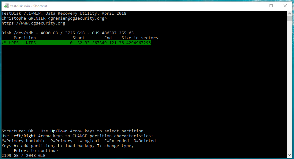

I followed your instructions and it found the drive again. I restarted the computer and now I can the drive as one whole drive in the windows explorer.
But still it shows as a RAW drive without any recognizable filing system for windows. Even though the data is still there. When I press "p" in the utility, it still lists all the files.
The error is however still there regarding the mismatch of sectors.
Any ideas on what I should do to bring back the table so that I can access data from explorer again.
Thank you so much for your help!
I have attached the diagrams for reference.
testdisk 7.png (46.44 KiB) Viewed 6809 times
testdisk 8.png (25.11 KiB) Viewed 6809 times
testdisk 9.png (33.53 KiB) Viewed 6809 times
#4 Post by cgrenier »
Run "cmd" (right click run as administrator) and "chkdsk /f f:"
