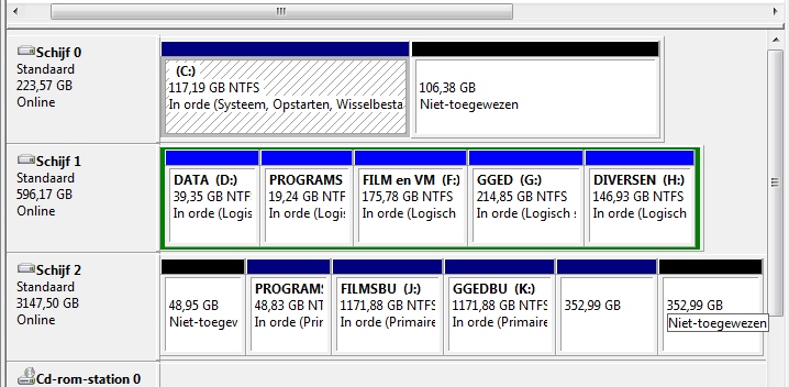

After installing win7 the right way now Windows disk management then gives
on theBUdisk ofcourse a first partition of about 120 GB Primary, active,
(which has about 21 GB written to it). About 2 TB not
assigned and beyond the 2 TB a partiton also not assigned and not
assignable because the disk is now with MBR.

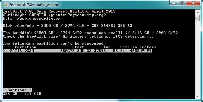

I ran testdisk with partition table set to Intel and got
The attachment NaDeepscan1.jpg is no longer available
Continue:
The attachment NaDeepscan1continue.jpg is no longer available

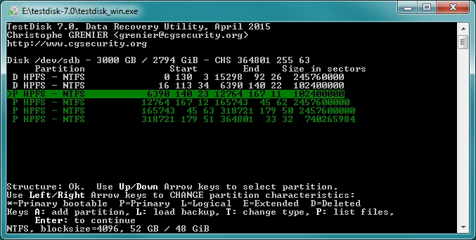

adjusted that to get the maximum green partitions. The first is the win7
the second the datbu which I can mis because of backups on external disks
the las four are respectively the former J,K,L,M partitions :

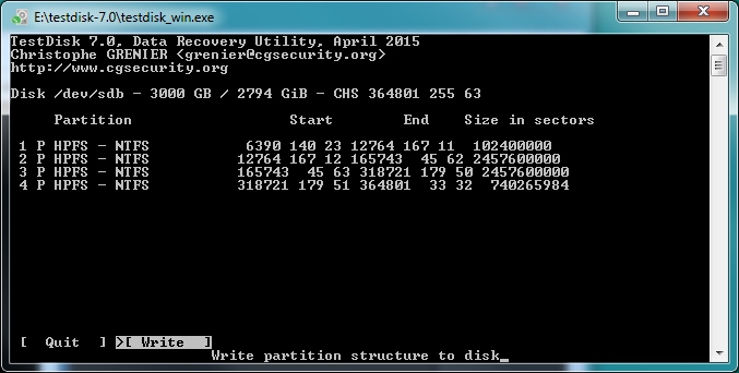

Continue and Write:
Until here I did it all before with the disk set to MBR ( as was )

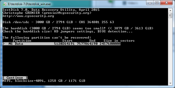

Because the M partiton was missing I repeated all with the disk set to GPt
with MiniTool Partition Wizard 10 and continued with below hoping to get
the last partition with that.

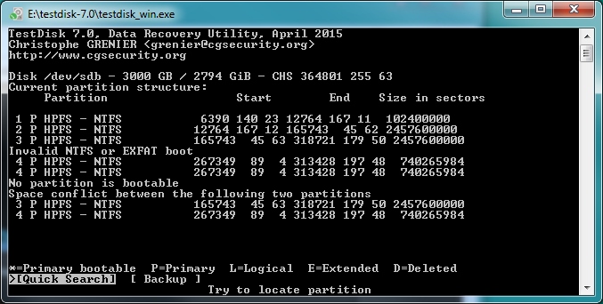

Analyse after write:
obviously there is a spaceconflict between former L and M.
So after reboot diskmanager shows again:
See further post below.

I think that with the write the disk was set to MBR .I'm not sure because
now there is more then 2 TB assigned. So I might got confused.

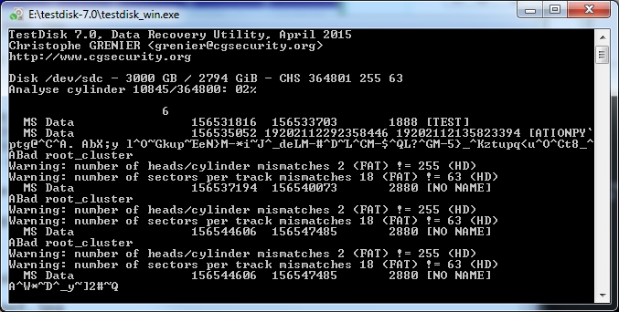

So I converted the disk to GPT again and did an EFI GPT quick search.
Result after about 30 hours:
All showed innitialy Deleted and the ones set to P were the only ones
with readable with files in it.
I did start a deep search now ( I know I should have stoped the qs and
started the deep scan right away) but I think that might be of no use.:
