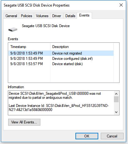

I'm having a big time problem with my Seagate 3000GB external HDD. It was starting to run slow, so I was moving data to an external SSD. I thought that maybe the powersupply was going, so I removed drive from it's housing and placed it in removable HD slot on my acer Predator. Here's where I think I messed up - I booted computer up with the drive inserted and I think computer didn't recognize drive as a bootable drive and it added script (disk.inf) to MBR or partition?? Device manager / disk management sees drive but says it is not initialized. Any help would be greatly appreciated. Thank you.

I tried both ... I believe the problem occured when I booted up the computer and the hard drive was connected to MB via a slot in the front of the computer, not by USB. You can see on the "Device Properties" image that the computer configured the HDD when it was booting.
