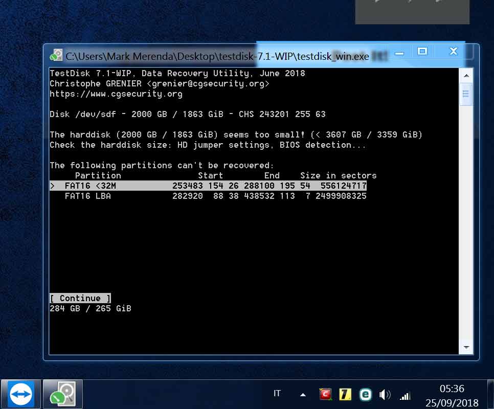

here's what it shows at the end of the deeper search; the HD is NTFS and does not have multiple partitions so i dont' understand why it happens like this except that when i wrongly started
to format it maybe i did it with diskpart in FAT but only at 1%. Hope you can tell step by step what to do after that and this topic get solved
Thanks again for the kind availability
Attached screenshot
Attached screenshot

You wrote that an NTFS partition is listed in current partition table, so the result of TestDisk, Analyze, Quick Search, Deeper Search is useless.
Run "cmd" (right click run as administrator) and "chkdsk /f d:" (replace d: by the correct drive letter).
What is the result ?
If it doesn't work, use PhotoRec on the partition, choose [Whole] instead of [Free]. Do not store the recovered files on this disk but somewhere else with enough free disk space.
It will not recover the original filenames but PhotoRec should get your data back.
