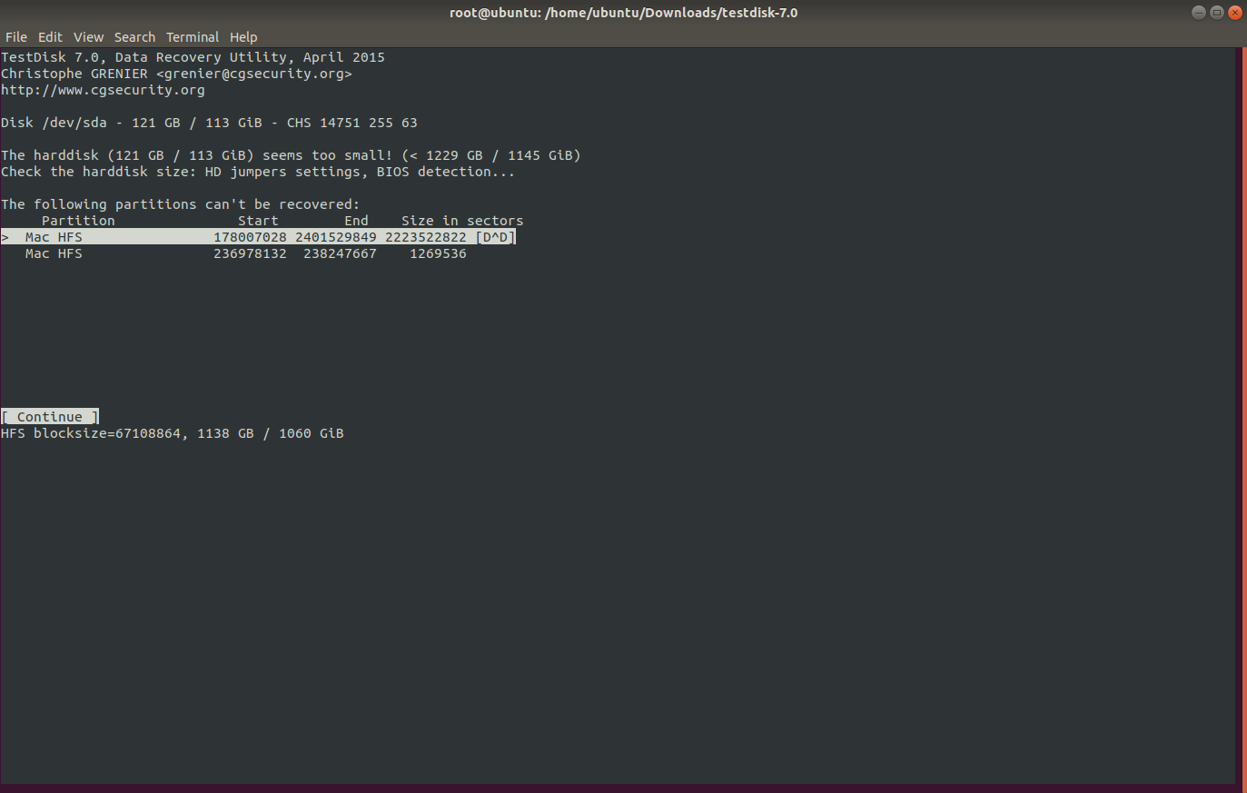

Here are the steps to my blunder on OS X High Sierra, Mac Book Air late 2015, 128 GB SSD Hard Disk. Since I am on road and away from my desk any help would be great.
The last structure was (What I remember) The partition is standard with what a new Mac Book Air comes with for 128 GB SSD except for a 8 GB partition I had done later with diskutility app which comes with OS X.
1. EFI
2. OS X HFS 113 GB
3. ext4 8GB
I was trying to install OpenBSD or rather check. As soon as I selected the main disk by mistake (I didn't even commit a write), I just exited the install program. Only later I realized that the partition had been over written with
1. EFI
2. OPEN BSD
So NO format was done, nor any partition table committed hence I have a little hope on recovery. On using testdisk I see the message below, So I don't know how to proceed. The HDF also shown as D^D.
"The following partitions can't be recovered:
Mac HFS 178007028 2401529849 2223522822 [D]
HFS blocksize=67108864, 1138 GB / 1060 GiB
Mac HFS 236978132 238247667 1269536
HFS+ blocksize=4096, 650 MB / 619 MiB"
a) Atttached is the screenshot of test disk
b) Below is the text of testdisk.log

Disk /dev/sda - 121 GB / 113 GiB - CHS 14751 255 63
The harddisk (121 GB / 113 GiB) seems too small! (< 1229 GB / 1145 GiB)

OS X Partition Overwritten by OpenBSD without confirm testdisk says can't recover
- Screenshot from 2018-09-29 09-39-16.png (67.65 KiB) Viewed 2045 times

The mainsuperblock of the HFS+ filesystem has probably been overwritten.
If the HFS+ partition was just after the EFI partition. We will have
EFI System 40 409639 409600 [EFI]
Mac HFS 409640 2223932461 2223522822 [D]
MS Data 222622672 236715991 14093320
ext4 blocksize=4096 Large_file Sparse_SB, 7215 MB / 6881 MiB
But the HFS+ and the ext4 filesystem will overlaps! So I don't know the exact location and size of the HFS+ partition.
You can always use PhotoRec to recover your data without the original filenames but try other data recovery utility, you may have better results.
