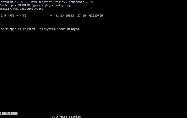

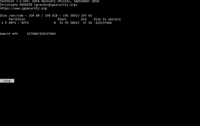

Now i m understanding that i have to choice Advanced menu...boot, rebuildBS.
After several hours of searching mft, finished and indicated this information.
But, the strange thing is that I chose, as indicated by the procedure, rebuild, and started again to search mft... this means, many hours again of searching
Y stopped and check list and showed this
Did i do something wrong?
