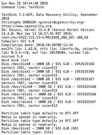

there are info from log file in attachments...
- 02.jpg (66.6 KiB) Viewed 4108 times
- 01.jpg (64.34 KiB) Viewed 4108 times
