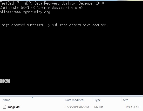

Attempting to create an image (which lasted ~8 hours), yielded nothing. It created an image.dd with 0 kb. "Image created successfully but read errors have occurred."
partition table type> None
Type > exFAT
Tried to Analyze. Quick Search, and Deeper Search yielded no results... (x_x)

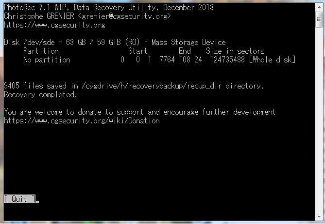

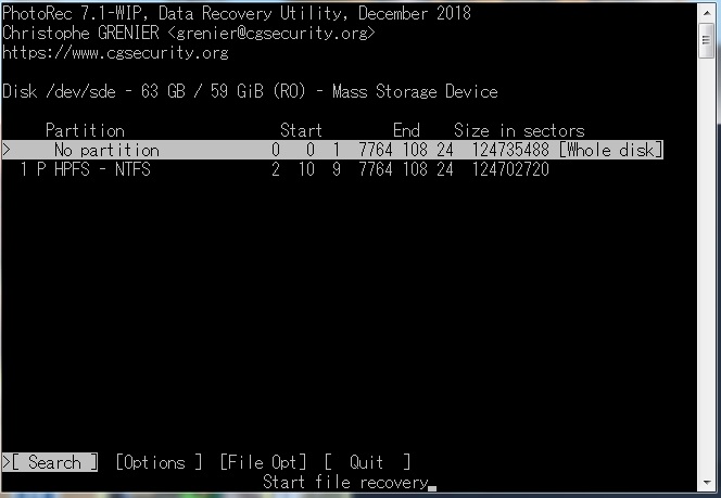

And to not test my luck any further, I quickly moved away from /Computer/, and fired up PhotoRec immediately to start the recovery process.
Fingers crossed, and...
Partition detected! It was shown as an "Unknown" partition previously, so this is starting to look good...
I selected whole disk, and began the recovery process.
Yes! Recovery successful! I was so glad that I retried PhotoRec again...

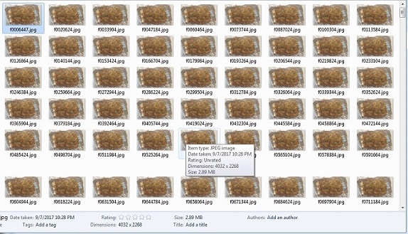

Turns out... all 9405 files are of the SAME image. For some weird unfathomable reason, ALL of them are of the same picture, just named differently, but same size, same date created, time, dimensions, everything. And it is the least important image of all... Is this some sort of a bad sign? Really bad corruption? Cursed picture/memory stick? Bad luck?
What does this mean?

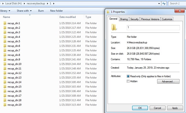

It is worth noting that upon examining the folder properties, it contains 18,799 files, and is 26.8 gb... that would mean that the recovery was partial?
-continued in next post-

this is what I meant... this would mean that there are actually 18,799 files of the same picture?!
Just, take a look yourself... ugh... T_T
(Baked prawns...)
I don't know whether I should laugh, or whether I should cry... it is hilarious, and yet disastrous at the same time... :')

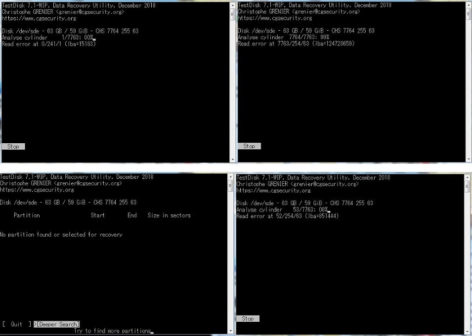

As mentioned, tried to create image for backup, but it seems that I am unable to do so successfully.
Only a small amount was created.
Does that mean it is unsalvageable?
Attempted Quick Search and Deeper Search, gave me read errors and detecting no partition at all.
Deeper Search got stuck at 00% for hours, which I just gave up and stopped.
Tried to use Advanced options. Strange, no partition found, again.

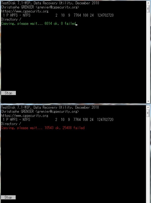

Immediately fired up testdisk to access the micro SD card, and into the Advanced options.
Success! I was able to copy the contents out somehow onto another location! (Fingers crossed, hopefully it's not full of prawns...)
...it worked! (somehow, somewhat, and no more prawns...!) For some strange reason, it copied files that I have never ever seen before as well, which I assume was deleted data from the previous owner. (The micro SD card is a hand-me-down from one of my siblings.) But most importantly, it managed to copied over the files that mattered the most, which are the pictures and videos taken from my phone. Thank goodness! Although there were alot of "failed"s, I don't really think that it matters anymore.
But now, the question remains, what were the other files that failed to copy over?
