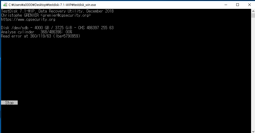

WD MY PASSPORT 4tb
selected the EDI, i have 2 partition
Analyse - i have 2 partition - Quick Search - Analyse cylinder - stop at 360 few mintues and error
Advanced - no boot partition - image are require 4tb
how can i restore my data?
4Tb drive went RAW, freez Analyse cylinder, should keep going?
- chature.PNG (15.14 KiB) Viewed 1698 times

Re: 4Tb drive went RAW, freez Analyse cylinder
You should try to clone the disk using ddrescue as described in https://www.cgsecurity.org/testdisk.pdf
now i am in 1433, use WIN 10
should keep going? or pdf p.52? , how can i restore my data?
any other way to image to small part? 4tb is too big
and if i give up my data, what should i do [format or exchange]? what would be better or no care?
