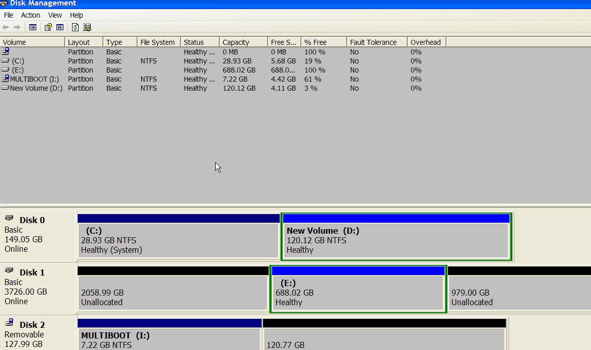

hello, i made a bit of a pickle with my 4TB Seagate running on MBR bios in WinXP x64.
I know, I know,.. its time to upgrade OS but its on the todo list ok?
I somehow had it partitioned as one big drive but its unclear if that was a GPT partition OR if i used SEAGATE diskwizard extended capacity driver and created a dynamic disk from the smaller partitions.
a SPANNED volume comprised of the two (or three?) partitions created with Seagate ECM (diskwizard).
so thinking i had disconnected the drive i deleted some missing volumes that were cluttering my disk managment console
its really unclear if the drive was connected. or this is entirely the windows record of the dynamic pairing that was delelted as i did not discover the issue for
some days at the least.
but it was gone , the partitions or the dynamic volume or something made it go away.

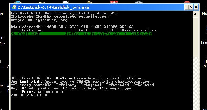

i ran testdisk analyse for hours and it came back with two partitions highlighted in green.
one looked big enough to be the entire disk but i am not good with the geometry numbers.
that was identified as partition 1
and also
partition 5 however it was identified as FAT16.
they were green so i chose to WRITE rather than deeper search.
quickly came back with "write error"
i fired up r-studio to see if it would yield clue to the structure info but iot was locked out apparently write protcted by testdisk.\
so after reboot now i see divisions of THREE partitions the first ending at 2TB which suiggest i guess that i went the SEAGATE ECM route
and... only the middle partiton was apparently written or recoverd by that testdisk manuveur.
the MIDDLE partition now has drive letter but unreadable at 600+GB.
i think perhaps fixing ONE item WOULD have corrected the rest but i chose wrong.
perhaps i should have written only the ONE large partiton found by testdisk and the other would have fallen into line.
question now.... DELETE? the newly written partition to make room for the large full partiton?
the smaller partion seems to maybe have BLOCKED the larger from being corrected?

The first line of testdisk.log contains the date/time!
You had the choice between Create and Append to log file when you started TestDisk.
Choose EFI GPT as your disk is over 2 TB.
You can also use TestDisk 7.0 instead of older 6.14.

so upon reflection i think what has happened is that three deletions occurred?
the spanned volume and the two partitions that comprised it, one of which is not
visable or accessible without the seagate extended capacity driver having mounted it..?
i think..
or something like.
but you say its GPT. are you able to be certain its straight up pure GPT? and
not the complex spanned concoction i previously mentioned?
also..
are the fat16 partitions caused my my having formatted each partition seperately thru the command prompt format command?
