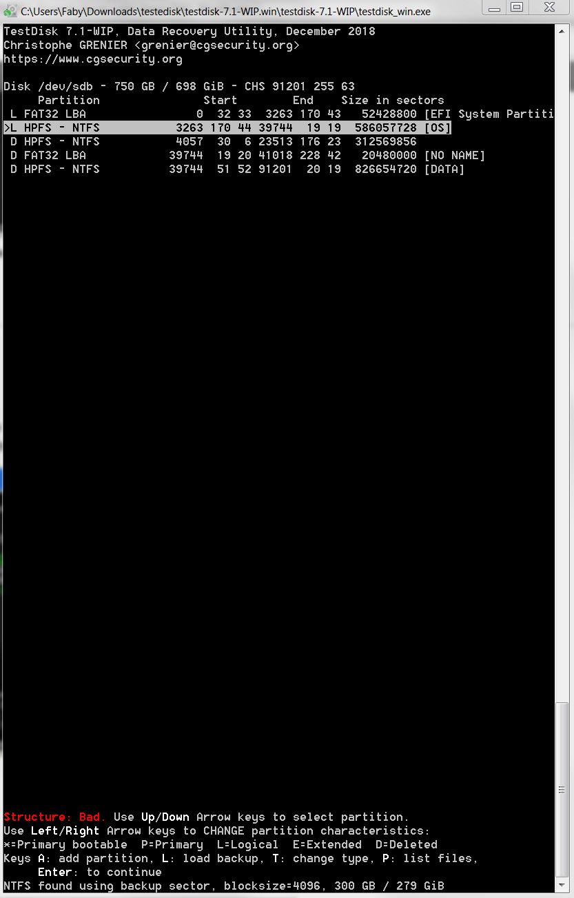

Hello everyone!
I'm new to this forum and I need some help.
My laptop didn't start anymore (it didn't find the operating system), so I took out the HD and put it on a usb adpter.
Using another pc, I searched for the problem, but this HD is working in a odd way.
The hard drive has 3 partitions:
1) recovery (hidden) - it seems fine, I've already done the image backup (who know, maybe it coulb be helpful in future).
2) operatin system (C:) - it doesn't work at all, windows file manager says that it's not formatted.
3) Data (my storage) (D:) - it works perfect, I've already done the backup with windows file manager. I've done windows scandisk with sector check and it's 100% ok.
So I used testdisk, I followed step by step guide (really well done). www.cgsecurity.org/wiki/TestDisk_Step_By_Step
Testdisk see all hd partitions and it works fine until deepscan.
At the end of deep scan, there is a red alert:
"Structure: bad"
And it's not possible to write the new partition structure.

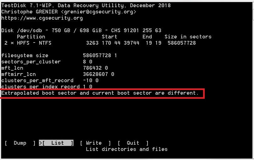

Re: Bad structure what to do?
Run TestDisk, Advanced, select the OS partition, Boot, RebuildBS, List. If you can see your files, choose Write, confirm, Quit and restart your computer.
Run "cmd" (right click Run as Administrator) and "chkdsk /f d:" (replace d: by the correct drive letter).

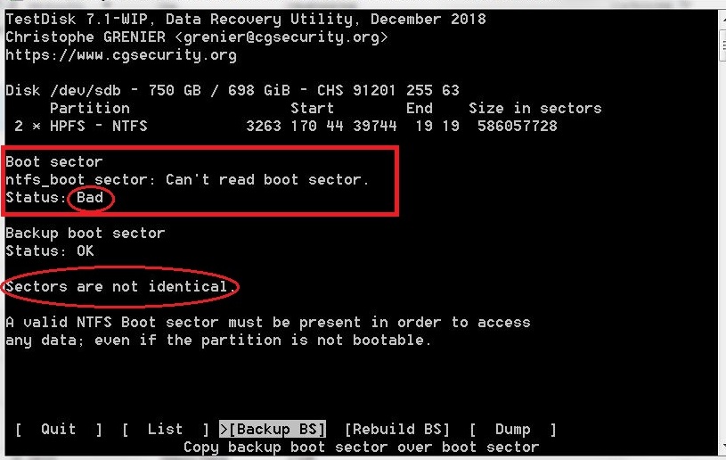

#3 Post by hddesperado »
Many thanks for your help cgrenier!
I'm following your tips.
This is "boot" step:
is it ok?
#4 Post by hddesperado »
this is "rebuild bs" step

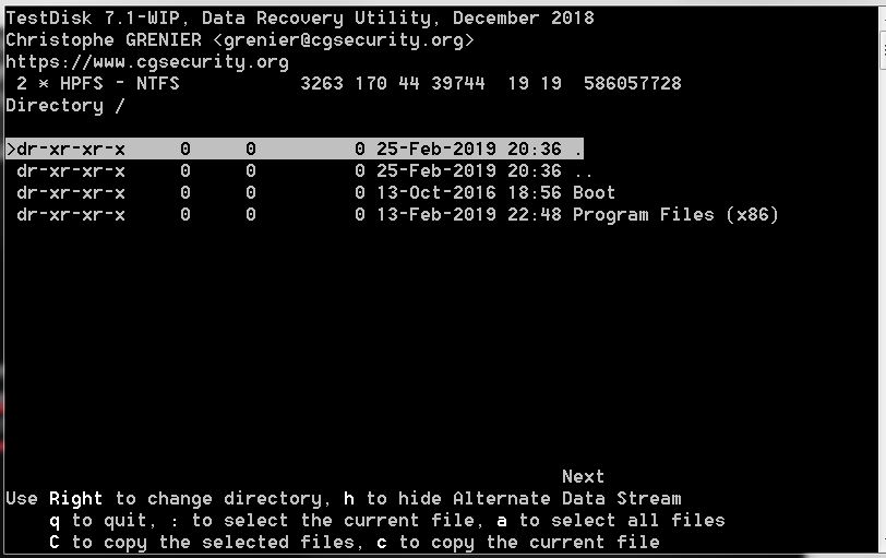

#5 Post by hddesperado »
File list seems fine....

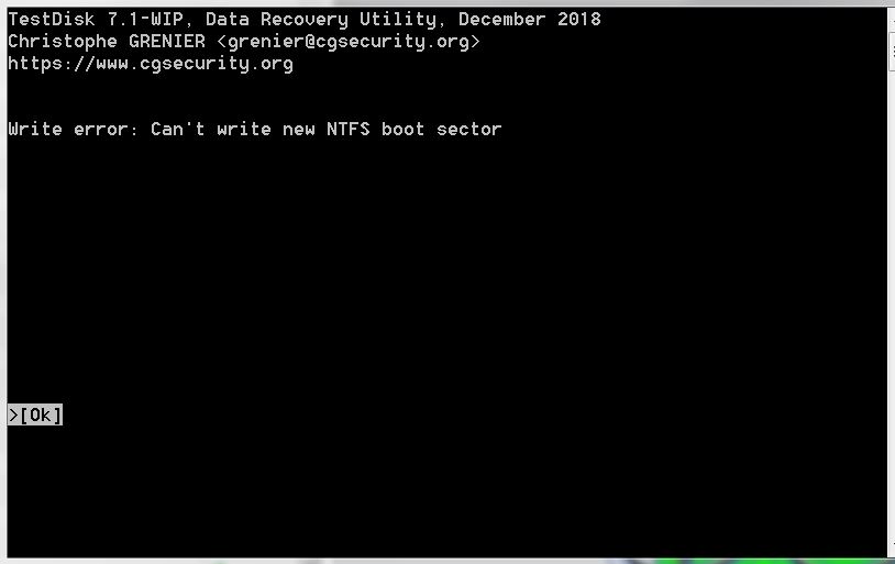

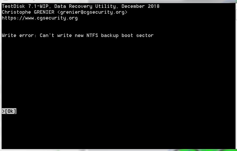

#6 Post by hddesperado »
Unfortunately, in the end testdisk failed to write...
what's wrong?
Posts: 3187
#7 Post by recuperation »
Sounds like testdisk does not have the administrative right to write on this disk (on sector level - below file system level).
Otherwise it could indicate a lack of available spare sectors to replace the unreadable physical sector that contains the boot sector information by a working one.
The spare sector issue is handled by the harddisk firmware.
If this is not a rights issue cloning might be necessary.

Posts: 3187
#9 Post by recuperation »
As an admin you should already have the rights.
Try to run testdisk from a bootable CD/DVD like Knoppix.
Check disk health.
#10 Post by cgrenier »
On Windows an antivirus may also prevent TestDisk from rewriting the boot sector.
