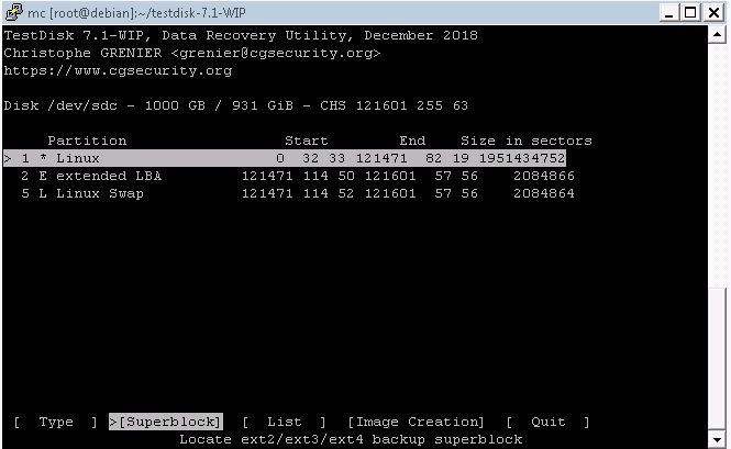

i was accidently delete files(with rm command, only files not folders).i was umount drive and make a clone disk then remount another system with readonly. (drive mount success)
After then scan with testdisk .ican see the files but 0 file size(all red).so i cant copy to another drive.

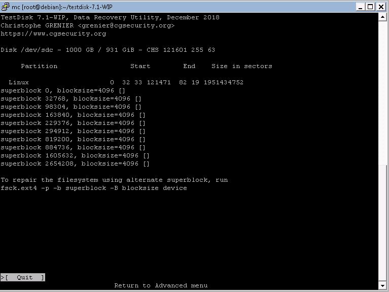

i was advanced=> select first linux partition (pic 1) => for useing Superblock (it says you must repair the file system) pic2=> then i was repair file system
fsck.ext4 -p -b 32768 -B 4096 /dev/sdc1 fix all problems then restart, check with testdisk, noting happends all files is red with size 0
iwas try this with all superblocks
i dont want to recover with photorec because drive has alot of files and folder, i cant reorganize them.

- pic2.JPG (60.67 KiB) Viewed 7525 times
- pic1.JPG (48.26 KiB) Viewed 7525 times

Extract from https://www.cgsecurity.org/testdisk.pdf
"With ext3 and ext4, it's possible to find the names of the deleted files but the location of the deleted data isn't available anymore, so even if ext3/ext4 is similar to ext2, it's not possible to recover lost files using TestDisk."
PhotoRec is the only way to recover your deleted files and yes, it's hard to sort the recovered files without the original filenames.
