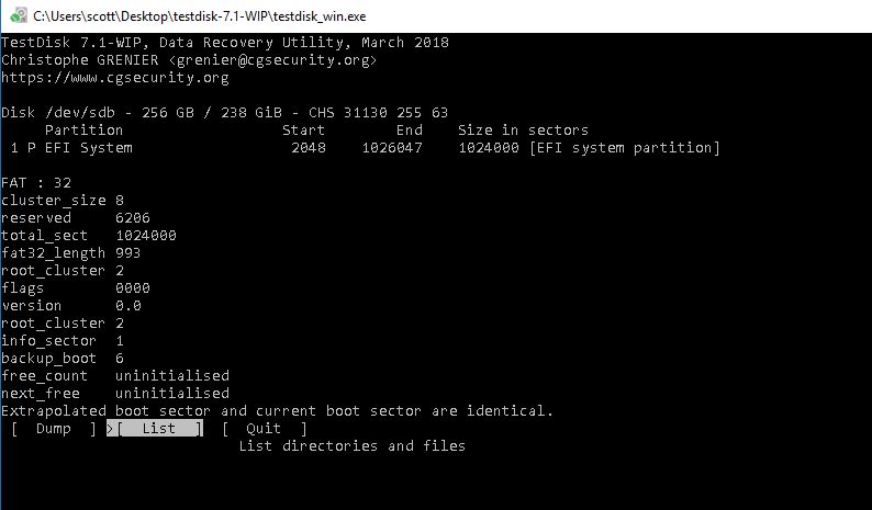

I can follow your instructions up to clicking on "[Advanced]". When I do, there is no menu item called "Boot" -- there is only Type // Image Creation // Quit. I choose "type" and set the type of partition to be FAT32 and then [Proceed]. And NOW I see that there is a menu Item "[Boot] Boot sector Recovery". I choose it, and then i can choose RebuildBS. Once that is finished, I do indeed see the partition files there (I.e. "I see /EFI").You can try TestDisk, Advanced, Boot, RebuildBS, List. If you see /EFI, choose Write, confirm, Quit.
Now i get confused, because your instructions say "choose Write, confirm, Quit". And I don't see "Write". I **do** see a file-picker which lets me back up the entire directory tree of the filesystem on the partition. I do this, and then press Q multiple times to exit test disk.
Should I have seen something which explciitly said "Write" and "confirm"? In any case, on the way exiting testdisk, I see this screen:
Unfortunately, MS still sees the partition as RAW in diskpart. But i see that you tell me to reboot. I will do that now.
- Capture.JPG (52.97 KiB) Viewed 5456 times
