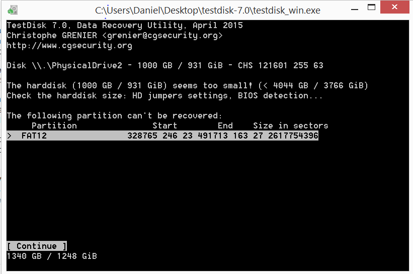

- The Quick Searched then revealed the problem I have now: It found the two small partitions (100 Mb and 30 Gb) just fine and labeled them as (* (bootable) und p (primary)) - also their files were browsable. The third partition it did not find, but it found a very large FAT12 partition it was unable to repair because the "hard disk seems to small".
Going into deep search did not help much (Screenshots attached):
- It also complained about the FAT12 partition during Deeper Search and told the same "hard disk seems to small" problem.

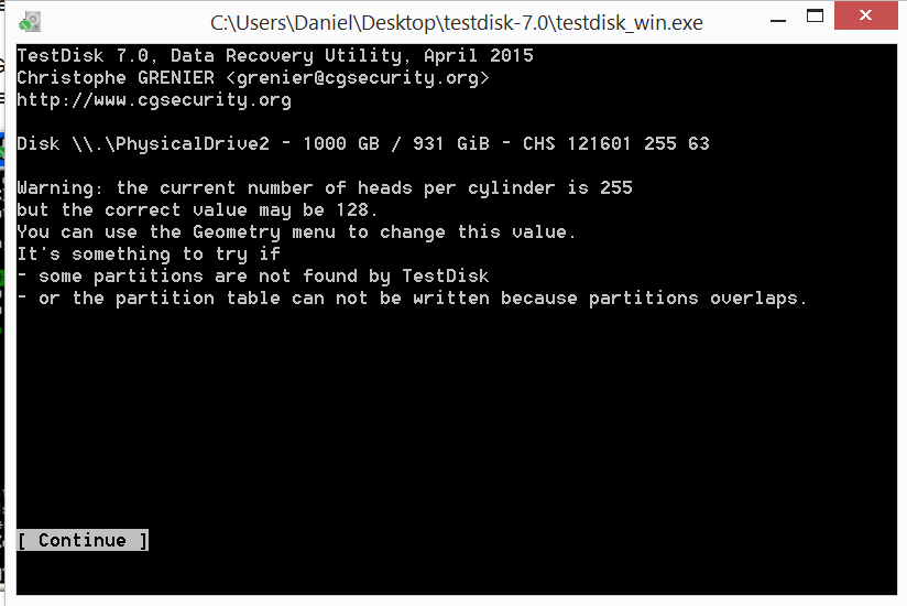

- After that it mentioned that the Number of heads per cylinder is 255 which might be wrong. 128 could be correct. However I read on the internet 255 is quite normal for NTFS

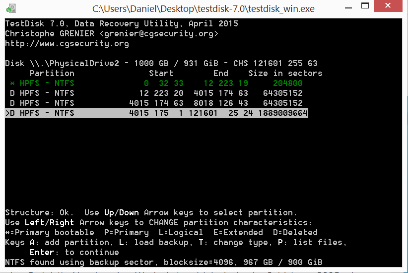

- It found the 100 Mb partition, which was as usual, the 30 Gb partition, which was now flagged as deleted (with a D), but both were still browsable. It also found another partition of the same size as the 30 Gb partition but it wasn't accessible (Sectors started with the end of the first 30 Gb partition). And then there was fourth partition that overlapped with others. It was browsable but empty. The two latter were also flagged as deleted (D).

You can ignore the FAT12.

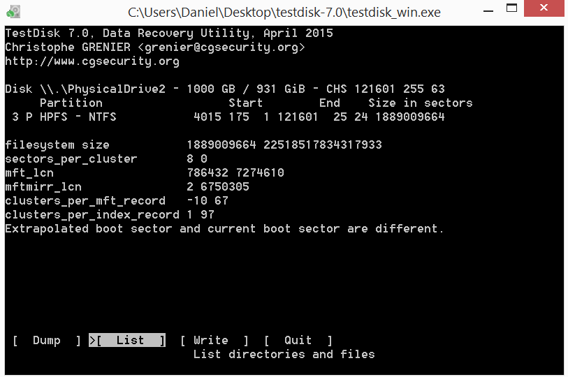

Run TestDisk, Advanced, select the last NTFS partition, if should start at cylinder 4015 and ends at 121601, Boot, RebuildBS, List. If you can see your files, choose Write, confirm, Quit and restart your computer.

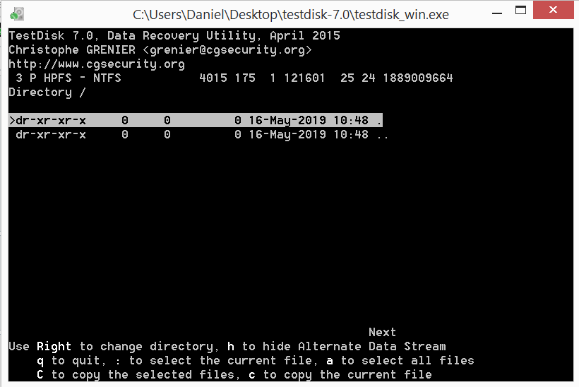

I did as you told me; however, after RebuildBS I tried to list the files and there were none. The only thing shown were two directories labeled ".." and "." - it was shown exactly the same content when I looked into this partition after deeper search. (as described in my first post) I attached the status message from RebuildBS and the fileslist as images. I am unsure what to do now - does this mean my files are lost?
