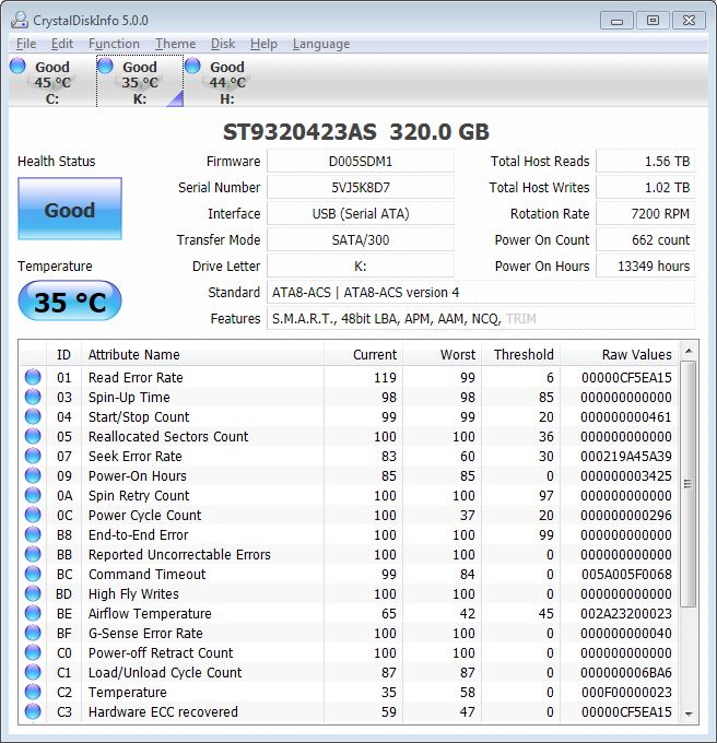

In CrystalDisk everything seems okay.

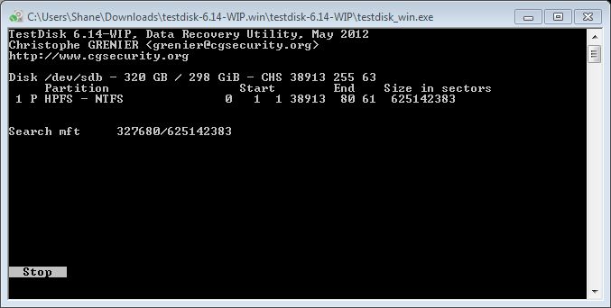

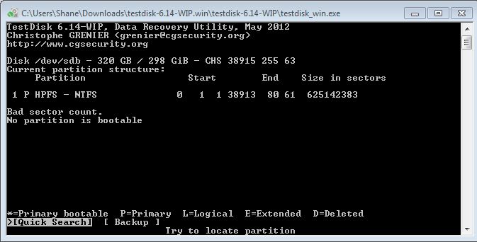

In Windows I've already imaged the drive with TestDisk and extracted the files with PhotoRec to an external drive. What I'm having trouble with is diagnosing/fixing the disk. I've attached pictures of the results in testdisk.
Initially it says Bad Sector Count - No Partition is bootable.

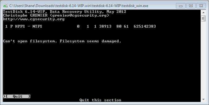

It then gives the message about heads per cylinder being 255 but may be 16. When I search it finds the same disk but when I try to open it (P) it says "Can't open filesystem. Filesystem may be damaged."
When I changed the heads to 16 in geometry it came back with Number of Heads - Cylinder Masmatch error

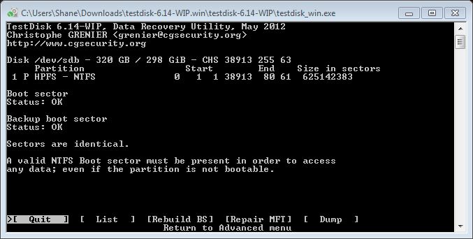

Would it be possible to diagnose your boot sector?

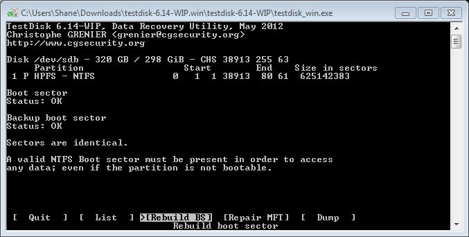

Here's the first screen Rebuilding of the BS is in progress
Re: Recovering 2.5" Seagate Momentum

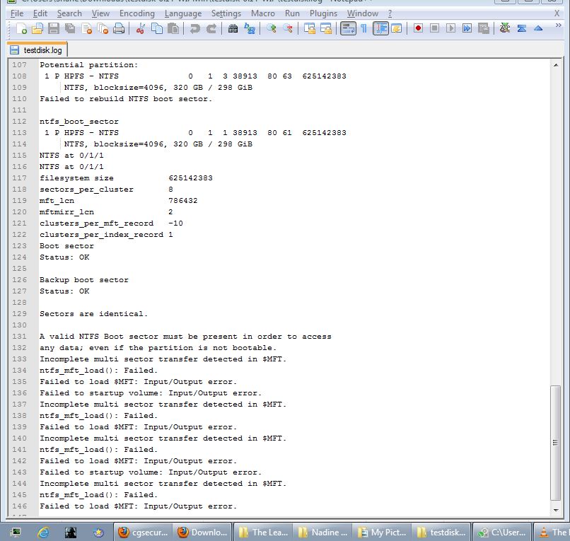

Rebuild BS finished with with the same screen as before (List - Rebuild BS screen - Repair MFT - Dump screen). Selecting "List" presented me with the "Can't Open Filesystem. Filesytem Seems Damaged"
I looked over the log and noticed it says "Failed to rebuild boot sector." Picture below, entire log here http://pastebin.com/Q6AysG8g
