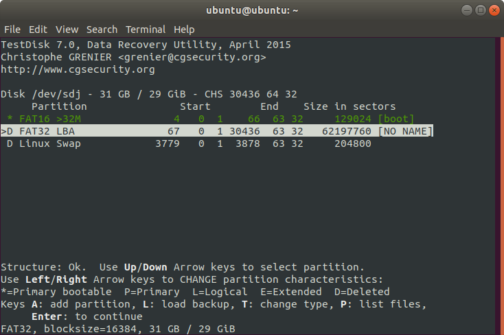

i accidently formatted my raspbian SD card with windows with minitool partition wizard.

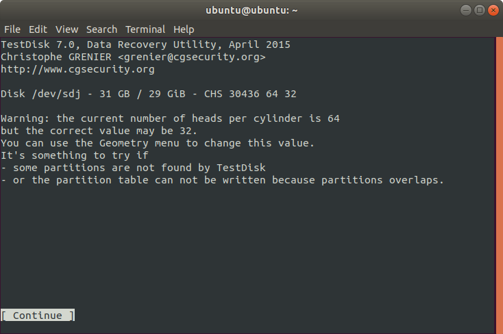

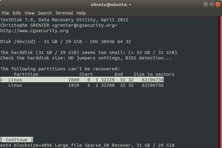

I downloaded testdisk and run a deeper search on the sd card but it gave me this:
Is there anz way to revover my partitions of the sd card?
Re: Raspbian Buster SD Card recovery
Too much data has been overiwritten to recover a functional raspbian SD card.
If there are some files you want to recover, you can try PhotoRec but you should reinstall raspbian on this memory card.
