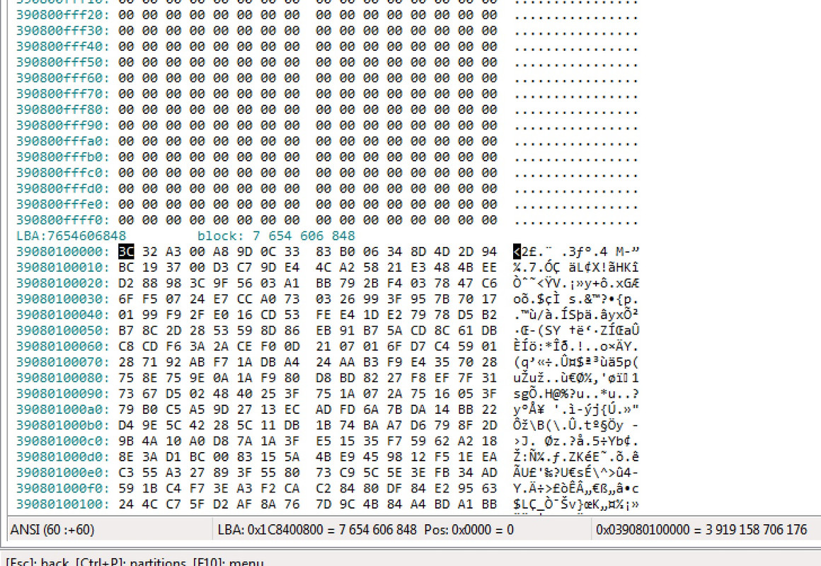

4. probably due to (3) there are large portions of hex 00's occupying the free space of the encrypted volumes. by using dmde's hex view i was able to find large swathes of these zeroes followed by data followed by zeroes and so on. the start to end sector ranges of these portions match the disk sizes listed in (1). screenshot of sdd5 for example. probable start sectors of partitions (ie first non 00 hex after lots of 00's):
sdd1: 4096
sdd2: 1468008448
sdd3: 2936014848
sdd4: 6920603648
sdd5: 7654606848
5. this is where i'm stuck. i see from several sources (example here) that by simply creating the partitions of the same sizes using the same partitioning tool (in my case minitool), i should be able to mount the veracrypt volumes again. BUT:
  • the disk is currently in MBR mode. If i try to initialize to GPT, minitool forces me to create a 128MB partition. this partition did not exist on sdd as it was promptly deleted after creation (when originally setting up the partitions on the disk).
  • minitool does not allow specifying start and end sectors.
I'm positive i can do this with testdisk but don't know how. Can someone help me finish? Also note that i'm working on a cloned copy of the disk to recover created with ddrescue/knoppix.
