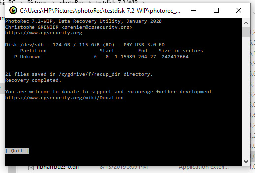

This is a PNY 115gb flash drive, no partition, bad boot sector etc with running testdisk in various partition formats,,, so I have now
ran it multiple times with photorec … it runs for about an hour or so and then kicks out with
the same 21 files recovered. I thought it might be background programs causing this Kickout - windows 10 edge screen popup "directory name invalid") but even with an msconfig shutdown of the background programs … it just did it again, only a little sooner than with the bg programs running …. thanks in advance in what to try next!

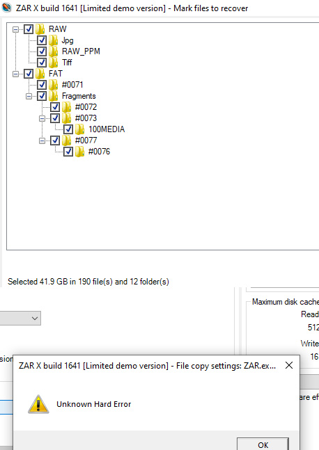

Yes, kicked out earlier in that mode. I tried to run it with zar x last night and it ran for almost 16 hours … then kicked out. Perhaps that can give someone a clue. There appears to be data there … but how to access it? It crossed my mind that it could be a momentary contact hardware issue where the contact disengages momentarily … and the software does/cannot resync ? Is that plausible?
- zar file display
- zar-1aa.jpg (90.03 KiB) Viewed 4823 times
- photorec final
- photorec(43).jpg (93.02 KiB) Viewed 4823 times

Try to clone the disk using ddrescue as described in https://www.cgsecurity.org/testdisk.pdf
Once it's done, remove the original disk and try photorec on the image file. When using PhotoRec, choose [Whole] instead of [Free].
