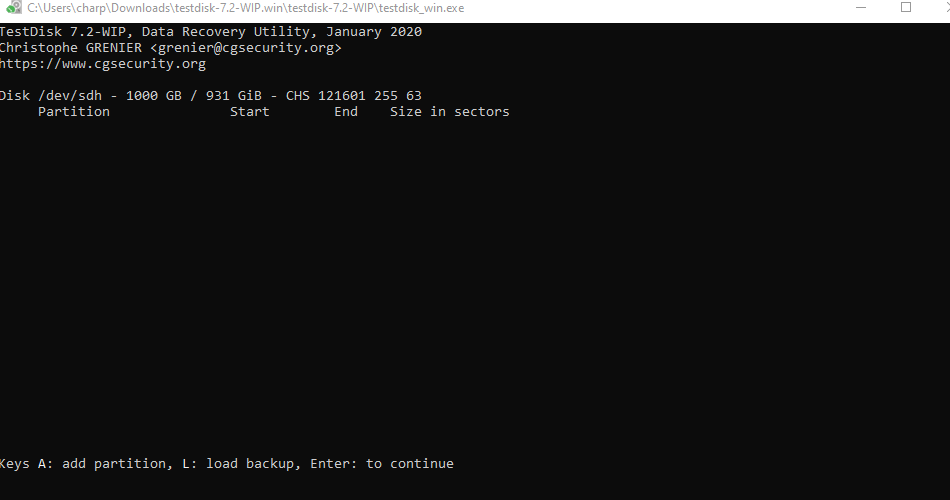

Hi!
I have a big problem on a disk, i do the setup give by Cgrenier and the deeper analyse is running..
But i want share this for more info..
after this:
and the safety of the disk is not good...
If someone can help me :)

After Deeper Search, you will probably be able to set the NTFS partition to *(bootable) or P(rimary).
On next screen, choose Write, confirm, BackupBS, confirm, Quit
If you have problem, please copy and paste the testdisk.log file content.

#3 Post by Azrael7 »
Hi cgrenier,
I find a solution, thank you very much :)
