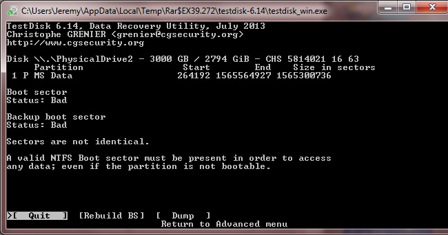

I got all the way to the last steps of your post and there's a couple of things I need clarification on as the options or wording are a bit different and I don't want to take any missteps. I completed the part that says 'Use type to force settings to MS Data and next NTFS' but the next part is a bit confusing. On the next menu I get a 'BOOT' option and when I select that I don't get 'BackupBS' as you said. I get QUIT, Rebuild BS & Dump. This is the screen I'm looking at currently.

Re: Please Help Me Rebuild/Recover Partition or Recover Data
Did you use TestDisk 64bit?
TestDisk 32bit is recommended.
In menu "Advanced" you should mark your partition, confirming at type, choose MS Data and then NTFS.
Check the boot menu again.
Your partition should appear as NTFS.
Upload another screen.

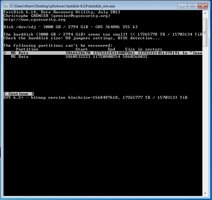

Forgot to add a screenshot. Here's where I'm at now and as you can see the numbers came up exactly the same as the OP so I'm concerned I might screw things up if I proceed as this is considerably less in size then my drive was. This was purely a data storage drive, not partitioned at all, GPT, NTFS with ~1.8TB of mostly photos and accounting info on it before windows displayed it as a raw drive needing formating after I had saved over the windows 2TB limit/flaw.
NOTE: these attachments seem to have loaded backwards so should be looked at from bottom to top. I find these forum attachment layouts fairly confusing
- And this is where I'm at now, wondering if I should proceed???
- TD_deepFinDATA.jpg (62.41 KiB) Viewed 6352 times
- Felt better when seeing this partition, though as shown, it's data amount is way smaller then what I had on the drive...
- TD_deepFinNTFS.jpg (85.4 KiB) Viewed 6352 times
- wasn't sure about this xfs partition
- TD_deepFinXFS.jpg (88.72 KiB) Viewed 6352 times
As your 3TB partition named DATA is listed, you can choose to write it.
