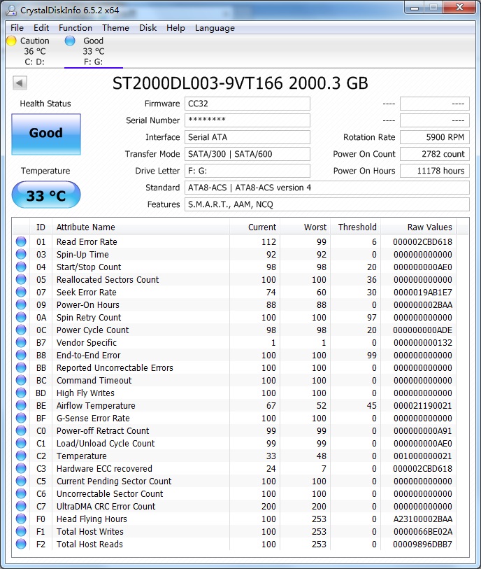

Can you check your disk using CrystalDiskInfo first?
Please download the portable version, because the installer (exe) contains the adware open candy.

The screenshot is here.
I'll try the cloning step. But please pardon me for being a new user, which tool do you you recommend for carrying out this talk, TestDisk or CrystalDiskInfo?
