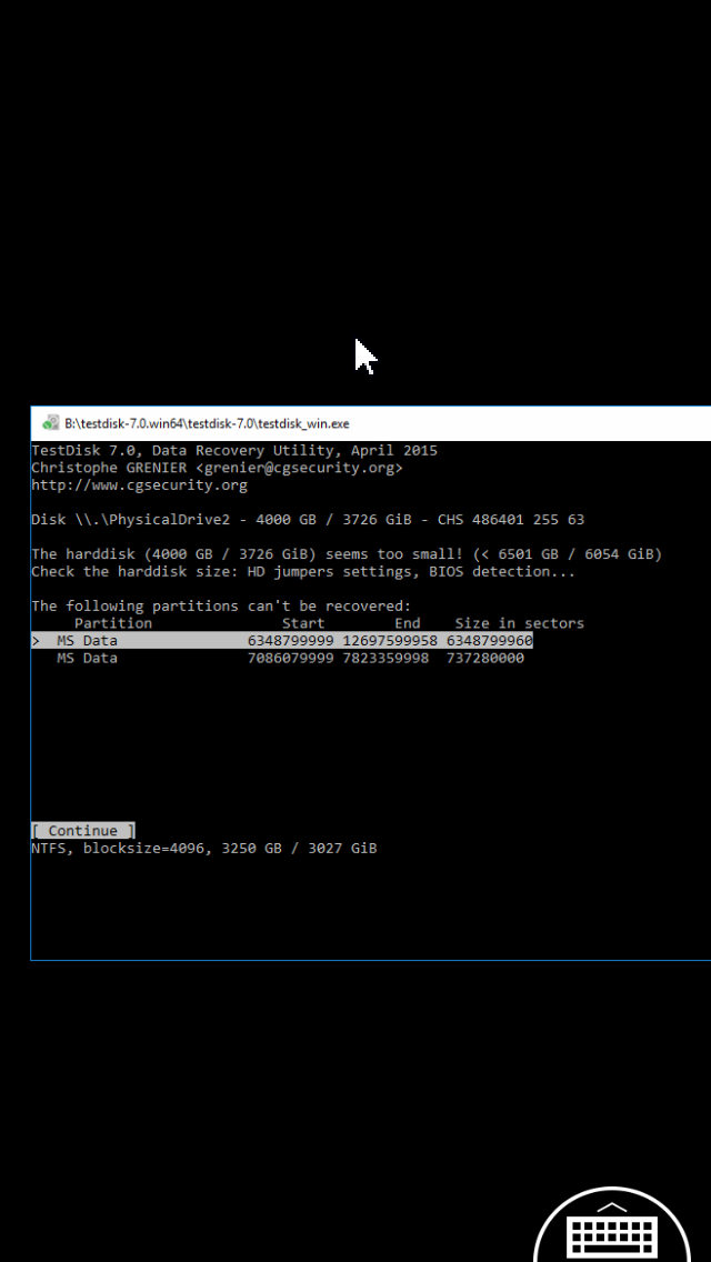

I received the following message while doing the Quick Search (I chose INTEL instead of GPT as I wasn't sure whether the partitions were MBR or GPT but now I've seen that the other drives are GPT so I assume that I should have chosen GPT here):
Disk \\.\PhysicalDrive2 - 4000 GB / 3726 GiB - CHS 486401 255 63
The harddisk (4000 GB / 3726 GiB) seems too small! (< 4559 GB / 4246 GiB)
     Partition               Start        End    Size in sectors
>  FAT16 <32M           334401 149  7 554335  59 35 3533234069
   FAT32                415820 234 31 504023 166 25 1416976906
I found the folders with the photos but when copying I get the following errors:
Please select a destination where /VB and any files below will be copied.
Keys: Arrow keys to select another directory
      C when the destination is correct
Copying, please wait... 0 ok, 9581 failed
The log-file says:
Can't create file \/VB/Fotoalben/ABI/P6263101.JPG: No such file or directory
The fact that the files were found brought back some hope, I really hope they aren't lost. :(
Also I am note sure whether I should try to recover the partitions or better just try to recover the files (photos).

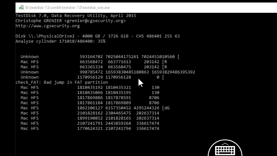

I attached a screenshot of how it looks so far. I never had a Mac partition. :/

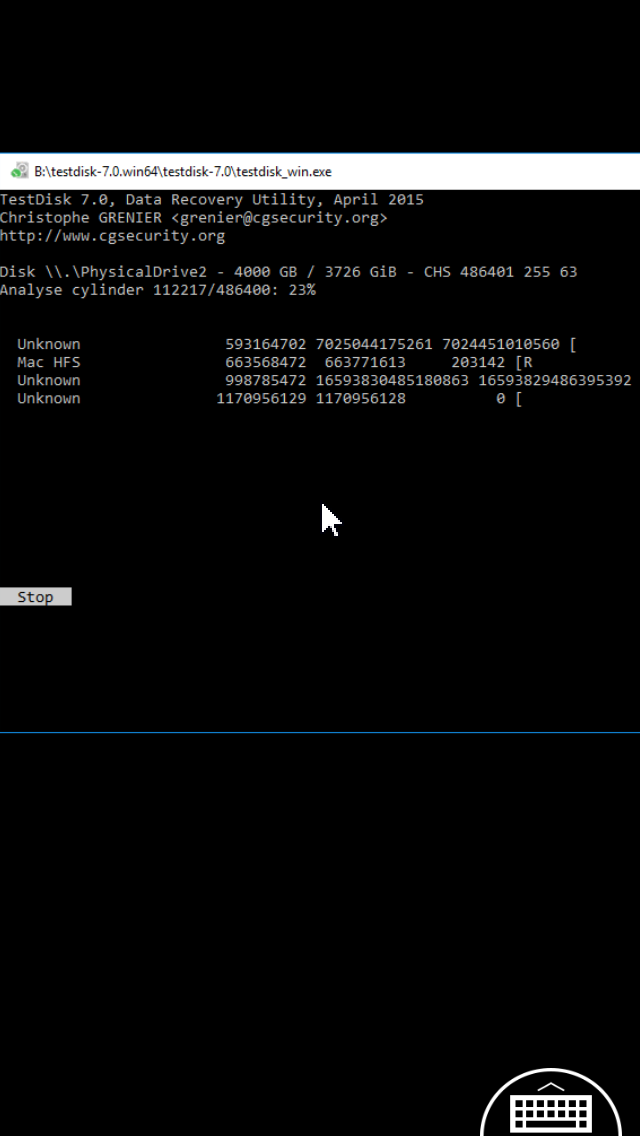

#6 Post by MaKin »
I'm doing a deep search and so far I'm seeing this. What the heck?
Why am I shown Mac HFS? I've never used it on my Mac...
Re: Recovering photos after deleting partitions (diskpart cl
#7 Post by Fiona »
When TestDisk runs on EFI GPT, it can recognize any HFS-partition by remnants, because Intel-Mac uses the same partition table type too.
It has no significance and you should only look for your appropriate partition type (file system) like FAT32LBA or NTFS.
I've answered your german topic!
