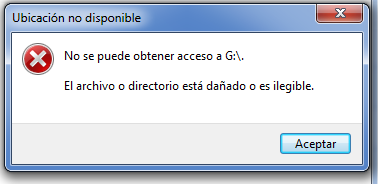

Hi, I know this is a popular question and have tried reading through the many threads but am unsure what relates directly to my problem and how to resolve it.

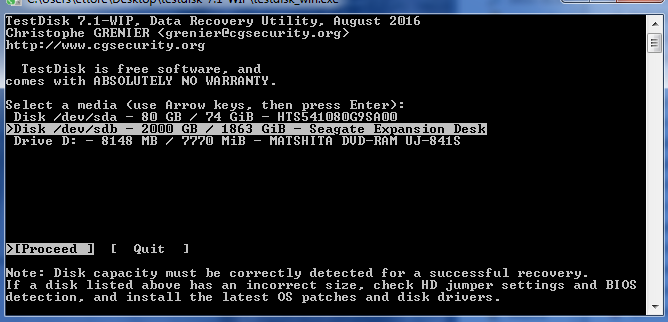

I have a 2TB Seagate external drive which was working fine up to yesterday afternoon. I had multiple power surges, yesterday, which caused the drive to switch off and on quite a few times in a matter of seconds and have a feeling that this has caused the drive to malfunction.
When I try to access the drive I get this message:
TD 001.PNG (24.8 KiB) Viewed 5520 times

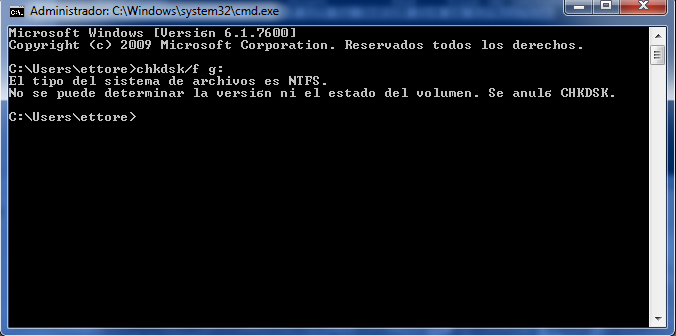

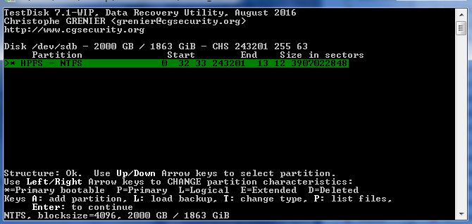

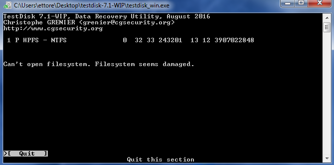

So, after a quick bit of research I tried ChkDsk and got this answer:
TD 003.PNG (55.84 KiB) Viewed 5520 times

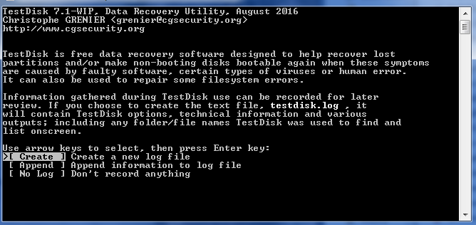

So a few more hours on the internet and I found TestDisk (I've tried to upload the TD log but as it appears to be a .log format it will not upload, so I am uploading the step by step process as screenshots, below. The last image shows the stage I am at now and I am wary about going any further as I don't have the first idea about what I am doing. The hard drive contains files which cannot be easily replaced relating to my business and I cannot afford to lose them as they are required for two ongoing jobs which must be completed this week... you could say I'm in a bit of a panic. If the disk cannot be repaired to a point where my computer can see it, is there a way I can transfer the files from the old drive to a new one, assuming I go and buy another drive? I am working on a Toshiba laptop, running windows Vista. Thanks, in advance for any help and advice you can give. Screenshots follow...
TD 01.PNG (43.86 KiB) Viewed 5520 times
For some reason the message board is not letting me add more images, so I will add them in subsequent replies...

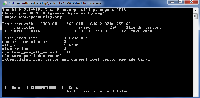

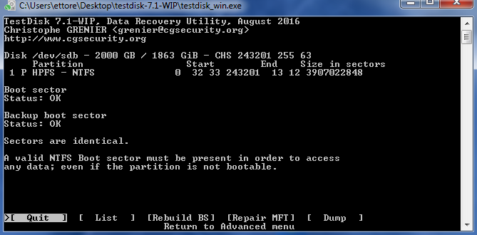

Re: External HD not recognised
Try TestDisk, Advanced, Boot, RebuildBS, List. If you can see your files, choose Write, confirm, Quit, restart your computer.
Please post the testdisk.log file content if it doesn't work.

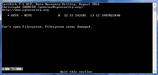

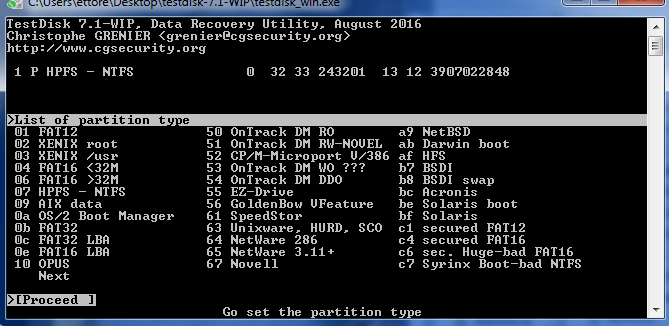

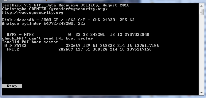

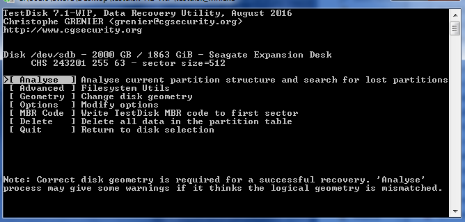

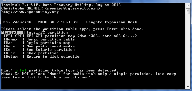

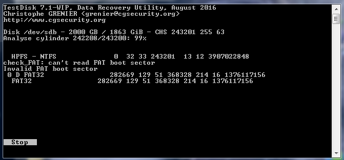

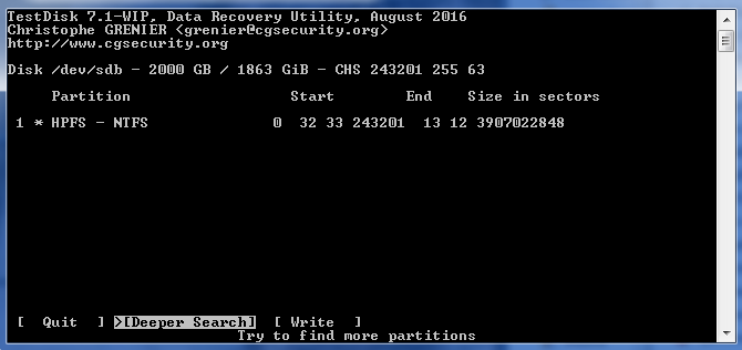

Thanks for the quick reply, before I try your suggestion I will let everyone have a look at the progress (or not) that I had made prior to my original posting. As I stated, I tried to post the TD log but the message board said that it could not be posted beccause it was the wrong file type.
These are screen shots of what I did yesterday and where I am at today... (apparently I can only add 3 files per message, as I have quite a few I will post in following messages too.)
TD 02.PNG (49.1 KiB) Viewed 5513 times
TD 03.PNG (43.28 KiB) Viewed 5513 times
TD 04.PNG (46.34 KiB) Viewed 5513 times

Below is a copy of the TD log
Sun Jan 15 15:04:16 2017
OS: Windows 7 (7600)
disk_get_size_win32 IOCTL_DISK_GET_LENGTH_INFO(/dev/sdb)=2000398933504
disk_get_size_win32 IOCTL_DISK_GET_LENGTH_INFO(\\.\PhysicalDrive1)=2000398933504
disk_get_size_win32 IOCTL_DISK_GET_LENGTH_INFO(\\.\C:)=79654027264
disk_get_size_win32 IOCTL_DISK_GET_LENGTH_INFO(\\.\D:)=8148013056
filewin32_getfilesize(\\.\E:) GetFileSize err Función incorrecta.
filewin32_setfilepointer(\\.\E:) SetFilePointer err Función incorrecta.
disk_get_size_win32 IOCTL_DISK_GET_LENGTH_INFO(\\.\G:)=2000395698176
Disk /dev/sda - 80 GB / 74 GiB - CHS 9729 255 63, sector size=512 - HTS541080G9SA00, S/N:202020202020504d4442414c4e58394741424739, FW:MB4OC60R
Disk /dev/sdb - 2000 GB / 1863 GiB - CHS 243201 255 63, sector size=512 - Seagate Expansion Desk, S/N:NA4JXNF6, FW:070B
Drive D: - 8148 MB / 7770 MiB - CHS 1942 64 32, sector size=2048 - MATSHITA DVD-RAM UJ-841S, FW:1.60
Disk /dev/sdb - 2000 GB / 1863 GiB - Seagate Expansion Desk
NTFS at 0/32/33
1 P HPFS - NTFS 0 32 33 243201 13 12 3907022848
Incomplete multi sector transfer detected in $MFT.
ntfs_mft_load(): Failed.
NTFS at 0/32/33
filesystem size 3907022848
mftmirr_lcn 2
file_pread(5,2,buffer,3907031039(243201/110/45)) lseek err Invalid argument
file_pread(5,2,buffer,3907031040(243201/110/46)) lseek err Invalid argument
file_pread(5,8,buffer,3907029248(243201/82/18)) lseek err Invalid argument
file_pread(5,8,buffer,3907029376(243201/84/20)) lseek err Invalid argument
file_pread(5,8,buffer,3907029504(243201/86/22)) lseek err Invalid argument
file_pread(5,8,buffer,3907029632(243201/88/24)) lseek err Invalid argument
file_pread(5,8,buffer,3907029760(243201/90/26)) lseek err Invalid argument
file_pread(5,8,buffer,3907029888(243201/92/28)) lseek err Invalid argument
file_pread(5,8,buffer,3907030016(243201/94/30)) lseek err Invalid argument
file_pread(5,8,buffer,3907030144(243201/96/32)) lseek err Invalid argument
file_pread(5,8,buffer,3907030272(243201/98/34)) lseek err Invalid argument
file_pread(5,8,buffer,3907030400(243201/100/36)) lseek err Invalid argument
file_pread(5,8,buffer,3907030528(243201/102/38)) lseek err Invalid argument
file_pread(5,8,buffer,3907030656(243201/104/40)) lseek err Invalid argument
file_pread(5,8,buffer,3907030784(243201/106/42)) lseek err Invalid argument
file_pread(5,8,buffer,3907030912(243201/108/44)) lseek err Invalid argument
file_pread(5,7,buffer,3907031041(243201/110/47)) lseek err Invalid argument
file_pread(5,8,buffer,3907031048(243201/110/54)) lseek err Invalid argument
file_pread(5,3,buffer,3907031056(243201/110/62)) lseek err Invalid argument
file_pread(5,3,buffer,3907031103(243201/111/46)) lseek err Invalid argument
file_pread(5,8,buffer,3907031119(243201/111/62)) lseek err Invalid argument
file_pread(5,11,buffer,3907031166(243201/112/46)) lseek err Invalid argument
file_pread(5,2,buffer,3907033088(243201/143/15)) lseek err Invalid argument
* HPFS - NTFS 0 32 33 243201 13 12 3907022848
Not an exFAT boot sector.
1 * HPFS - NTFS 0 32 33 243201 13 12 3907022848

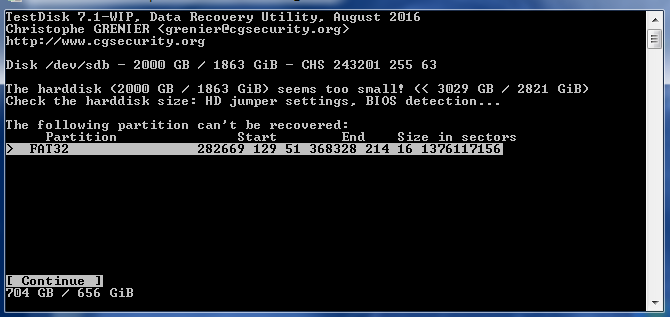

cgrenier wrote:Try TestDisk, Advanced, Boot, RebuildBS, List. If you can see your files, choose Write, confirm, Quit, restart your computer.

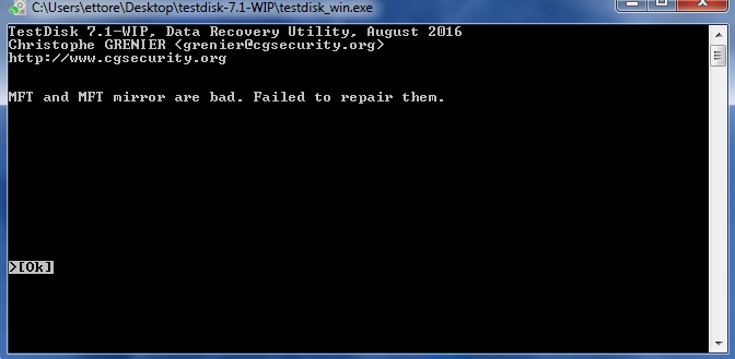

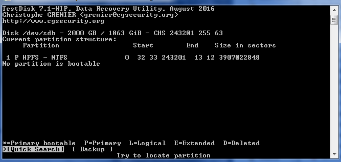

I tried this and seemed to get nowhere also tried a few other things... result images below
TD 12.PNG (59.65 KiB) Viewed 5491 times
TD 13.PNG (54.56 KiB) Viewed 5491 times
TD 14.PNG (56.08 KiB) Viewed 5491 times
