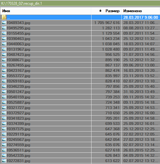

Now I'm using 7.0 win version and have the same problem. PhotoRec writing on disk 14+ GB doc-file

I have enough space on destination folder. I care of my HDD health status. Would be better if I can set output folder (HDD) and temporary files folder (RAM-disk). Filesize limit will help to get result faster.
- PhotoRec_01.png (24.37 KiB) Viewed 8048 times
