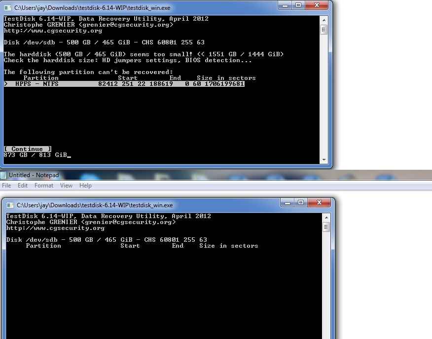

i have a hitachi 500 gd external drive which is inaccessible after i accidentally dban it . however the dban program only ran for 2 percent i have quickly unplugged the usd hdd.
now wheni plug it back to computer i am not able to see it under my computer however can be seen under disk management with unallocated message.
i am able to see the files on the hdd using other programs , but unable to recover .
when i run the testdisk it completes the quick search however am i stuck in window where it say the the hdd is too small and gives no further options to move forward.
i will upload the screenshort . please advise
many thanks
jay

Re: hitachi 500gb is no longer accesible
Did you use TestDisk 6.14-32bit?
Can you repeat your diagnose as far as possible?
So at least, I'll get infos about your current situation.
I would need infos form Analyse and Quick Search first.
But I assume if you wrote 2 percent into your file system, then it might be damaged.
But to judge your situation I'd need more infos.
Normally there should be continue displayed to move forward if you press enter?when i run the testdisk it completes the quick search however am i stuck in window where it say the the hdd is too small and gives no further options to move forward.
thanks fiona , i will get the infos as soon as i have done the dignosing ,
besides i could actually see all the files and folders when icare data receovery areused . thanks for your response , iwill provide snapshots and testdisk.log
please find attched the result from diagnosis
thanks.
jay
thanks.
jay
There is no partition in your partition table anymore.
Testdisk.log was aborted.
Would it be possible to run Deeper Search?
It's not Quick Search.
Reason is, I assume that your boot sector could be overridden also.
That's why I'd like to try to find your backup of the boot sector and have a try to list your data.
If Deep Search finds your partition, then press p to have a try to list your files.
Please let me know, did you see your data or an error message?

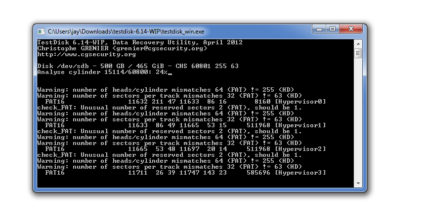

kumarjay75
- Posts: 8
- Joined: 06 May 2012, 10:21
hi fiona ,
the attached file is a snapshot from deeper search with none option.
it has run about 24 percent now, however does the stats show any sign of successfull recovery.
thanks
jay
thanks
jay
- testdisk..png (48.28 KiB) Viewed 11784 times
The scan only provides some infos about FAT-partitions.
Please let it finish.
The backup of the boot sector is normally located at the end of the partition/volume.
I assum it was a NTFS partition?
Did you only use one partition using the whole space?
