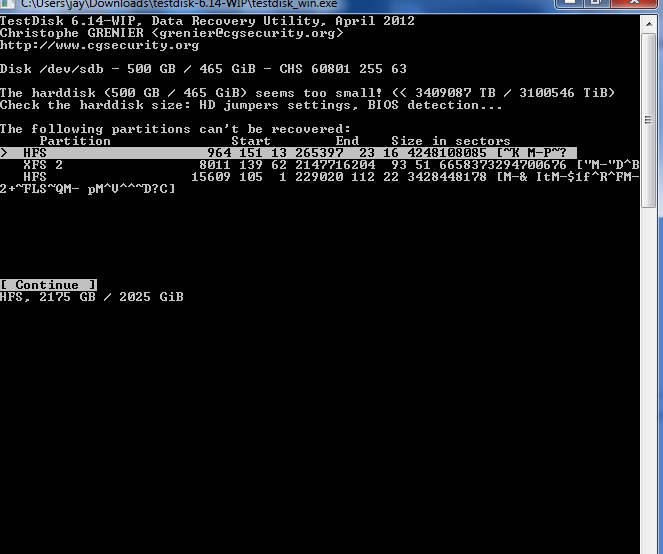

hi fiona
the uplaoded is the snapshot take from after completion of deep seearch with none selected
no log were logged .
hitachi 500gb is no longer accesible

- testdisk..png (40.58 KiB) Viewed 5214 times
Re: hitachi 500gb is no longer accesible
This is not the result, but the message about partitions where are not recoverable, because they end after disk limit.
If you press enter at continue, you'll get to the results!
This might be important.
Thanks Fiona
I did get some results after continue , some listing in green.
Can you give the steps I will try out. Will probably have to do again.
Yes, you should do it again!
I'd need infos from Deeper Search when your partitions are listed.
Please check them and press p to have a try to list your data.
