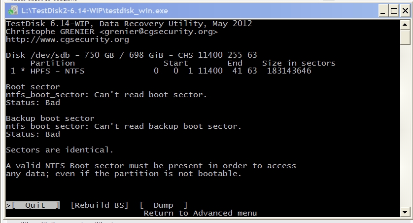

I'd like to do a boot sector diagnose and have a try to list your data.
In case if it would be succesful, you could copy your data.
Mark Type and press enter.
Press enter to continue.
At the left side you see your cursor blinking.
Write 07 (zero - seven, it's the partition type code for NTFS) and press enter.
Confirm at Boot.
Please let us know, do you see your data or an error message.
Infos will follow.

I have been rebuilding the the BS for 4 hours...My BS is about 180000000, the rebuild has reached 27 million and I have about 15200000 to finish the process. It is taking longer then I suspected and what I have read from other posts is that may be a sign of a courrupt, faulty file system, :x I HOPE NOT :cry:
Fiona, IF the recovery is successful and I am able to view all my files AND copy them to a good disk -
THEN, would it be okay to >>choose Write and confirm<< and then In Analyse, choose to rewrite the partition with the correct partition type.
What do you feel Fiona :?:
anticipation...
ducklip :)

The strange thing is, that you can't select your disk, because it's gonna change to drive?
I can't judge this behavior.
That you've probably read errors displays the diagnose of CrystalDiskInfo.
If TestDisk gets to an read error it might be hang?
A boot sector diagnose is actually a good try not to stress your disk as much.
In the meantime, did you clone your disk or did you create a sector copy?

WOW :shock: TEST DISK is still trying to rebuild the BS...after 10 hrs it is at 76000000 of the 180000000 it has to reach...
No "errors" - so I suppose I should let it continue, or should I end it and try to capture an image with *ddrescue* :?:
What should I do ? :arrow: :?

Well I'm sorry to report bad news Fiona :oops: After 12 and1/2 hrs the outcome was not optimal.
I suppose I had better get busy with "ubuntu rescue remix" ddrescue... :roll:
Or do you have some tricks up your sleeve Fiona? 8-)
