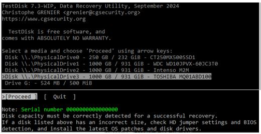

Hello, good afternoon everyone.
Please excuse my poor English, as Spanish is my native language.
My computer is an Intel(R) Core(TM) i7-7500U CPU @ 2.70GHz 2.90 GHz, with 8.00 GB of RAM installed. Windows 10 Home (v.22H2) 64-bit.
The partition on a TOSHIBA 2.5" 1TB SATA3 hard drive connected to my PC via USB disappeared.
It contains information I don't want to lose.
I downloaded Testdisk 7.3-WIP. I ran it, and without changing any of the parameters suggested by the program, it doesn't finish its job. It freezes.
The only strange thing I notice is that the program detects "0000000000000000" as the serial number of the device to be scanned.
[img]https://tinypic.host/image/Testdisk-00.3g4swx[img]
I would appreciate your help. I can send screenshots if you're interested. Thank you very much.
2025 03-22 Testdisk-00.jpg (34.1 KiB) Viewed 52478 times

As far as I know, the zeroed serial number doesn't matter.
Try to connect your 2,5'' disk internally in a desktop computer using a different cable.
Post your log file.
Post your smartmontools log file to learn how the disk thinks about its health status:
viewtopic.php?f=5&t=10910
Avoid using the jpg format for Terminal screenshots, p.e. png is more suitable.

When I say "TestDisk has frozen," I mean I follow the steps the program tells me to, and it stops:
I run the "TestDisk" program and It shows me.
>[ Create ] Create a new log file.
I press "Enter". It shows me:
Select a media and choose 'Proceed' using arrow keys:
>Disk \\.\PhysicalDrive0 - 250 GB / 232 GiB - CT250MX500SSD1
Disk \\.\PhysicalDrive1 - 1000 GB / 931 GiB - WDC WD10JPVX-60JC3T0
Disk \\.\PhysicalDrive2 - 1000 GB / 931 GiB - Intenso M2M
Disk \\.\PhysicalDrive3 - 1000 GB / 931 GiB - TOSHIBA MQ01ABD100
Drive G: - 524 MB / 500 MiB
I select: Disk \\.\PhysicalDrive3 - 1000 GB / 931 GiB - TOSHIBA MQ01ABD100
I push “Enter”: >[Proceed ]
It shows me:
Please select the partition table type, press Enter when done.
[Intel ] Intel/PC partition
>[EFI GPT] EFI GPT partition map (Mac i386, some x86_64...)
[Humax ] Humax partition table
[Mac ] Apple partition map (legacy)
[None ] Non partitioned media
[Sun ] Sun Solaris partition
[XBox ] XBox partition
[Return ] Return to disk selection
I push “Enter” and it shows me:
>[ Analyse ] Analyse current partition structure and search for lost partitions
[ Advanced ] Filesystem Utils
[ Geometry ] Change disk geometry
[ Options ] Modify options
[ Quit ] Return to disk selection
Disk \\.\PhysicalDrive3 - 1000 GB / 931 GiB - CHS 121601 255 63
Partition Start End Size in sectors No FAT, NTFS, ext2, JFS, Reiser, cramfs or XFS marker
1 P MS Reserved 34 32767 32734 [Microsoft reserved partition]
P=Primary D=Deleted
>[Quick Search] [ Backup ]
Try to locate partition
Analyse cylinder 121601/121600: 99%
MS Data 2048 1953523711 1953521664 [Externo Fotos 1TB]
Stop
And from that moment on, the program freezes. I've left it for hours without taking any action, and nothing.
I have to stop the program with the Windows task manager.
[Externo Fotos 1TB] is the name of my HDD

6) I send you three files.txt obtenidos with HDD Guardian Toolbox and a Testdisk.log file.
HDD Guardian Toolbox USB scan.txt
(28.18 KiB) Downloaded 3636 times
HDD Guardian Toolbox System information.txt
(6.12 KiB) Downloaded 3579 times
HDD Guardian Toolbox Smartctl scan.txt
(13.51 KiB) Downloaded 3733 times
Thanks again for your attention.

In the previous post, I couldn't include more than three text files. Here's the one I missed.
testdisk.log
(1.96 KiB) Downloaded 3678 times
Another attempt:
If I enter this link in my browser I see the image: https://tinypic.host/image/MY-Disks.3vGIww
