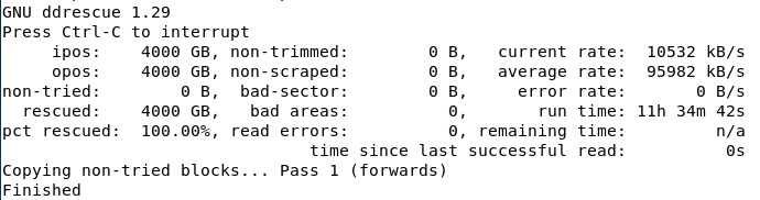

This is an update:
I used ddrescue to clone the disk to another drive as an image file, it only has been one pass. Since it was the first pass I didn't use the -r option. There were zero errors.
Just to be cautious a few questions before moving on:
Since there were no errors there is no reason to for additional passes with ddrescue, correct?
Should I next attempt to repair or overwrite the MFT with TestDisk on the image file?
This is the logfile from ddrescue:

This is a screenshot:
ddrescue mybook.jpg (40.96 KiB) Viewed 81451 times
Posts: 3188
Re: Can My Partition/Hard Drive Be Recovered? "Filesystem seems damaged."
#10 Post by recuperation »
crashtech wrote: 22 Mar 2026, 01:46 Since there were no errors there is no reason to for additional passes with ddrescue, correct?
Yes.
