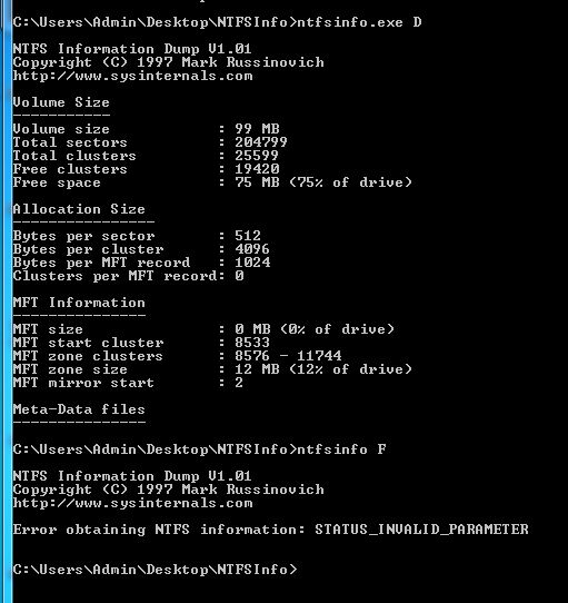

Results of NTFSInfo attached. Not sure if this will help.
- NTFSInfo_1.JPG (60.31 KiB) Viewed 3993 times

MTF (Master File Size) size = 0 MB is a problem?
If I could recover System Reserved and the boot (C) partition, that would work for me. There is nothing important in DATA2 partition.
Any help with what to do next would be great!

Re: CHS Numbers for Seagate ST3400620AS
No ntsfinfo shows in partition F because it is not ntfs (it's raw).
To check that your $MFT is zero try nftswalker to view structure ..
http://dmitrybrant.com/ntfswalker
If so then you may be down to file recovery using commercial software.
More on that later when you've checked $MFT on C partition.
