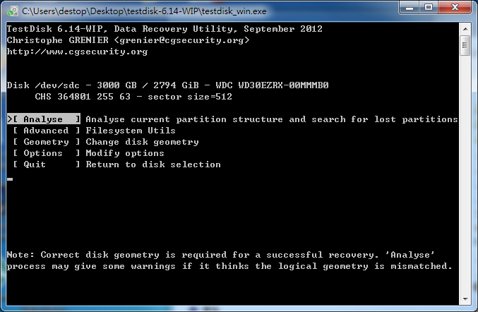

1. so here is what I did, ran the testdisk_win.exe under adminstrator
2. select partition table type to "EFI GPT", and bottom of the screen also shows EFI GPT partition table is detected

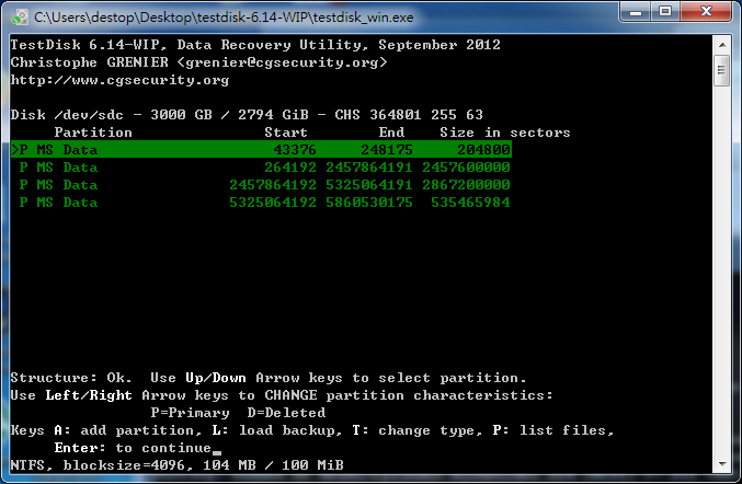

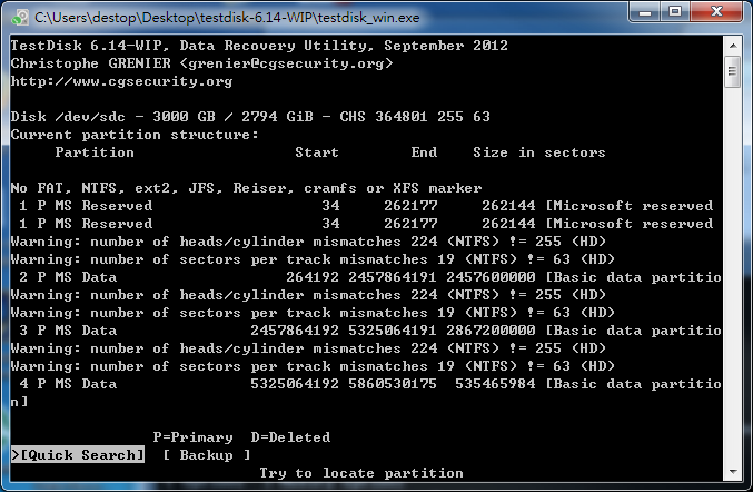

3. choose the hard drive, and did a quick search
4. found 4 partitions, which is correct ( 3 formatted partition and unused partition)
now what do I do ?? I try to list the files, but error msg shows damage partition ?

also what does Number of cylinder/head mismatch
and Number of track mismatch means ?/?

cylinders and heads mismatch, so I think you would need to change the geometry. it should be under advanced.
an example of this is on the testdisk home.
