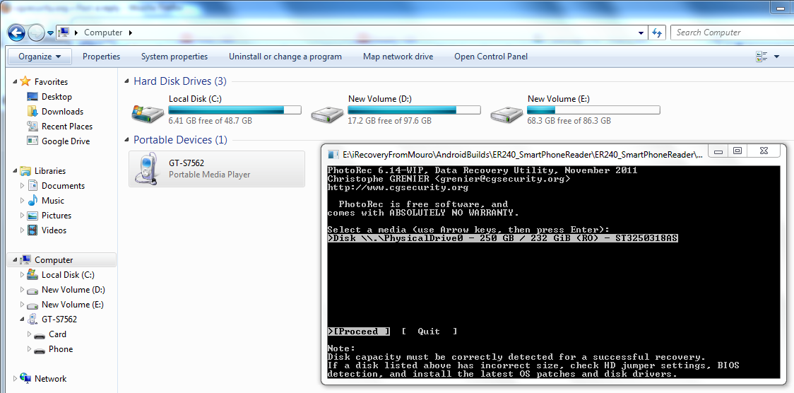

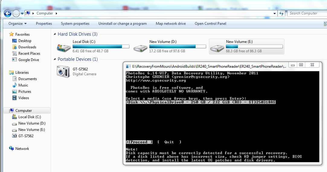

No. I have connected my Samsung Galaxy S duos device. My PC has detected that device but the same is not detected by Photorec. If there is something else, what can I do for it.
Herewith, I have attached a snapshot for it. It shows only my hard drives not shows my digital camera. I have connected my phone in a CAMERA(PTP) option as well as Media device.
Let me know your thoughts.

- MTP option

- CTP option
- Capture.PNG (147.2 KiB) Viewed 7735 times

When you connect your phone, it must be in USB mass storage mode (not in Media mode or Samsung Kies mode)
