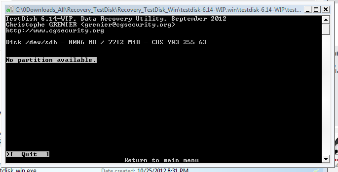

Thank you, but Advanced doesn't give me the option of Boot. It only gives the option of image creation.
I had to list it as no partition, because all the other choices gave me no options, except that there is no partition.
I did click on Type under Advanced which sent me to Boot after I put it as FAT32. I think it WAS Fat32 before it was RAW- not sure if it stays the same? Rebuild BS shows this:

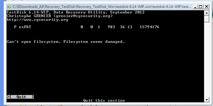

If I list it as ex-Fat it shows this:
I've already used file recovery tools to recover all that it appears I can, but I really wanted the actual names on some of the files, and some other things that aren't recoverable. I really really had hoped there was a way to rewrite the boot sector, or whatever is wrong, so that I can see everything again as it was before it became RAW.I tried to attach the log, but it wouldn't allow it. I looked at disk geometry as well - is there some way I could fix it that way instead? I don't know however, what numbers to put in myself. Is there any other option?

first_fat 2, second_fat 3
FAT : 32, reserved=2, fat_length=1
fat32_boot_sector
P FAT32 0 0 1 983 36 13 15794176
Bad
Bad
First sectors (Boot code and partition information) are not identical.
Second sectors (cluster information) are not identical.
