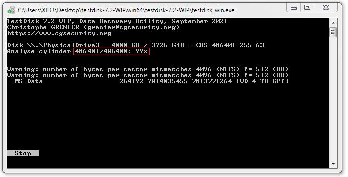

  1. 1st write
    I run testdisk > analyse to 100 % in just 2 seconds > only found 1 GPT partition with my hdd name [WD 4 TB GPT].
    with warning number of bytes per sector mismatches 4096 (ntfs) != 512 (hd)
    Then I proceed using choose default * to write and reboot.
    After reboot I still cannot access the hdd.
  2. 2nd write
    I run testdisk > analyse to 100% in just 2 seconds > only found 1 GPT partition with my hdd name [WD 4 TB GPT],
    With warning number of bytes per sector mismatches 4096 (ntfs) != 512 (hd)
    This time I choose L, write and reboot.
    Then it become 2 partition the data (2TB) and leftover ext space.
    After this I just realize that this HDD should use primary, not * or L.
  3. 3rd write
    I run testdisk > analyse only 60% around 20 minutes wait> found 1 partition > stop analyse,
    This partition don't have my hdd name.
    This time I choose P, write and reboot.
    Still no access to HDD.
After 3rd write I realized that it got worse.
Here is the latest analyse > quick search > quick search result:
  1. analyse
  2. quick search progress
  3. quick search result
Here it the latets deep search results:
  1. Analyse show sector size 512
  2. Deep search progress
  3. 2048GB partition, maybe from forced MBR 2TB.
  4. 4TB GPT Partition with HDD name
    1. It show correct HDD name, size, and path
  5. I'm sure this is not partition I'm looking for, no data inside

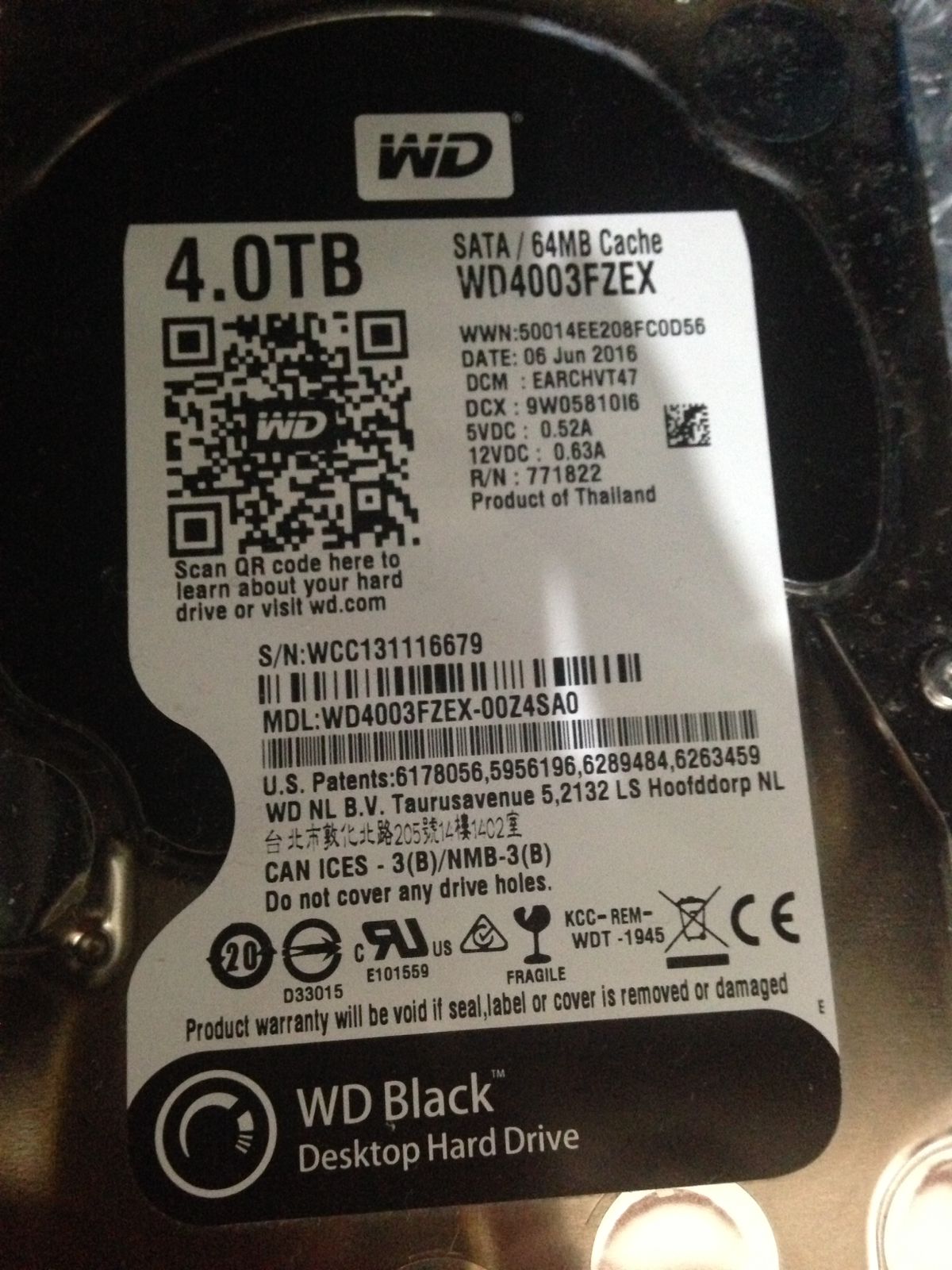

recuperation wrote: 04 Nov 2021, 20:50 What is the maker and model of the 4 TB hard disk drive?
recuperation wrote: 04 Nov 2021, 20:50 Did you buy a "naked" single drive or a package containing a drive in a box and a USB connector?
WD black 4TB. naked.
WhatsApp Image 2021-11-05 at 09.01.45.jpeg (245.23 KiB) Viewed 16148 times

Using direct SATA cable connection to my mainboard.
When I run testdisk > gpt as partition table > quick search.
It found my partition, but stuck in 99%.
It said : Analyse cylinder 486401/486400 99%.
testdisk analyse gpt.JPG (68.46 KiB) Viewed 16018 times
Testdisk didn't respond any input, so I forced close the testdisk app.
Then I run again,
This time, when Analyse cylinder 16/486400 00% and just found my partition,
I immediately stop the analyse.
Here the log:
testdisk.log
(267.59 KiB) Downloaded 989 times
