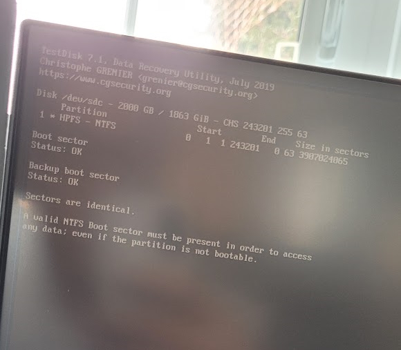

My computer was rebooting too with RebuildBS. I also tried with TestDisk 7.1
I tried yesterday on "ALT Linux Rescue" and TestDisk didn't stopped after the "RebuildBS" (sorry for the bad quality):
As I said before, the main boot sector was bad. I was able to fix it with the backup boot sector.
This was done the day before I took this picture.
Now I think I'm just at that point where I need to rescue my files on a new HDD.
If you think there is something I could try to repair my disk, I would gladly accept your help.

Use a pendrive linux of your choice to exclude a broken Windows 11 installation or a difference in the code base as a possible reason for a crash.
That is pretty wrong. Testdisk is crashing and you have not seen any of your files in Testdisk.
