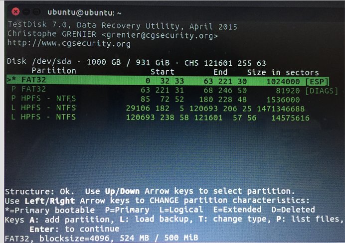

Hi, Thanks @cgrenier . I created a live USB and booted from Ubuntu and install TestDisk using the command
sudo apt-get install testdisk
I was able to follow till step 9.6 Pls see attached image.
I had 2 partitions prior to clean. Partitions were 250 /750 GB respectively. Don't see them here. Can you pls check and suggest how to proceed further ?
